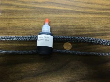

I think the adhesive comes in a small plastic bottle and says "heat safe gasket glue" - that's what I got with my cooktop.
The big calk tube with gray gritty stuff is furnace cement. That stuff is neat, it's soapstone dust mixed with furnace cement and is really sticky.
Hmm, I received 3 tubes of what you are calling furnace cement, one with the new door gasket, one with the first cooktop kit that had shipping damage, and another with the replacement cooktop kit. Am I using the wrong thing for adhering the gaskets?
I think a call to WS is in order. The only thing I ever got from WS in a Tube that was white/grey and gritty was furnace cement which might be ok to use with the gaskets, but it's worth a phone call.
It's odd they shipped me a squeeze bottle of gasket glue with my cooktop, but what sounds like furnace cement with yours.
I used gasketing material that I bought at a local stove shop. It is sold by the foot-not expensive. I did use glue that Woodstock provided some time ago.
1 small tube is more than enough to do the job. I have attached a photo of the 2 different size gasket material that I used as well as a penny for size reference.
Simple- just glue the smaller one in first then the larger one on top of it. No need to use much glue. You don't want the glue to saturate the gasket and stiffen it up.

Yup Binko's glue is exactly what I was talking about. The furnace cement is in a long white calking tube with a threaded nozzle fitting on one end.
Well the large tubes of furnace/stove cement are what woodstock sent to me three different times for installing gaskets... I suppose it works for that function but I'd rather use the thin black cement (I have a tube from menards- a rutland product). The stove cement is hard to spread thin as it has a lot of thickness/body. I think I'll source my own grey gasket material and gasket cement and have a go at resealing both the cooktop and the door.
I would tend to agree, furnace cement seems too thick for gaskets. I used it on my old VC Resolute, but I had to be careful to apply it very sparingly.
