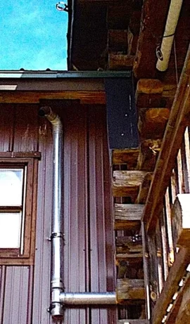

My stove flue exit, then horizontal 3 feet, there is tee with cleanout down, 5 feet of straight flue pipe pointed straight up, then a 90* elbow and tapered exhaust termination.
Bought a HD Craftsman (great sale, last one there) leaf vac / blower to pull air through the low mount cleanout using adapter at leaf vac inlet, it then blows what ever ash it gets out across yard. opening the stove door let it pull anything out of there too.
  • [Hearth.com] Proper height for Pellet Stove Clean-out

You could certainly have another clean out tee above ground like tbear853. I have two , one inside behind the stove, and one outside. What is your layout and plan?
