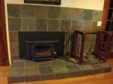

I have the Enviro kodiak insert with the 2.5cuft box thats built for zc fireplaces. It weighs in at 450. This will be our 3rd year and it works great, in fact its going now with temps at 39f outside. I built a raised hearth out of 2x6, durock and natural slate. That alone weighs as much as the stove but most floors can handle it. we also ran an insulated ss flex liner to the top for added security since the original chimney was a prefab double lined one.

if you can, please post a photo of your raised hearth.

Here's ours. We have already burned through one holder's worth of wood this season. It holds about 1/10th cord. We are still doing the nasty job of stripping wallpaper off the surrounding wall so that we can paint and then add a mantle.
