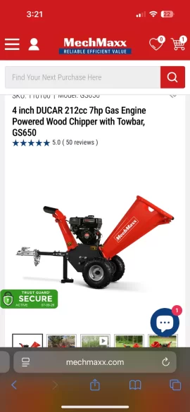

I forgot to mention I rebuilt the engine on it a couple years ago so it’s not completely beat up. Definitely aware it’s only about 25 hp give or take a few but even on the low end will still have more power than my 1023e or the 7-15hp self contained drum chippers I was looking at as well
EDIT: This style of self contained chipper is what I was looking at
