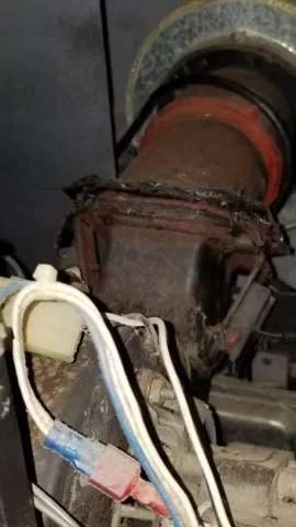

Is there supposed to be a gasket between the exhaust transition and the exhaust adapter? I had to slide the insert out to replace the convection blower and the exhaust transition and adapter separated. It looks like there is gasket material between them, but I couldn't find anything in the manual. Then when I close everything back up, should I put silicone or RTV around it to prevent smoke seepage?

I would put RTV on the FACE of the adapter so it seals.
