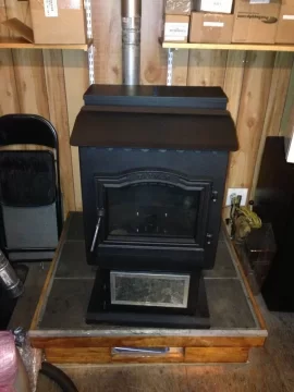

See pics below
1 - Quadrafire CB1200 "The Classic Bay" - I painted the grill Flame Proof Flat Aluminum from the Auto Parts store. Also I just got the optional Fire Brick backing that I have to throw in. :)
2 - Harman P-61a - I found a tile that I cut to fit the frame.

I dont like the fact that the CB 1200 does not have room temp mode. In retrospect I may have chosen a different stove for that reason alone. The CB is bone simple to clean and service. It also holds a boat load of pellets although to completely fill the hopper is difficult and can be messy as you have to always level them out as the door is small compared to the hopper size. The OAK is also a bit of pain as the stove essentially breathes from the bottom base. I ended up sealing the base with silicone along with a lot of places on the firebox so it would burn using outside air instead of pulling from the base.
That said its a good stove no real complaints.
