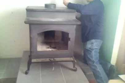

Any thoughts on this stove? I'll upload pics, it looks to me to be in pretty good shape.

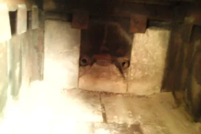

It's a good heater, though this one looks like it's been worked hard. The front burn tube is sagging. It also looks like a lot of firebrick is missing. I think this stove uses pumice firebrick like the PE.

How serious is the burn tube issue?

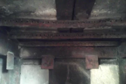

This indicates it was probably over fired at some point or likely on a regular basis. I would fully inspect the rest of the firebox for any cracks or bulging. The warped tube could effect the secondary burn and also the board and blanket that rest on top may not sit flat. Speaking of which it might need a new board and blanket if it was burned that hard repeatedly. Hard to tell in the pic what is going on above those tubes. Looks wrong up there unless you have found one of the really old stoves that used a steel plate or firebricks for the baffle?
