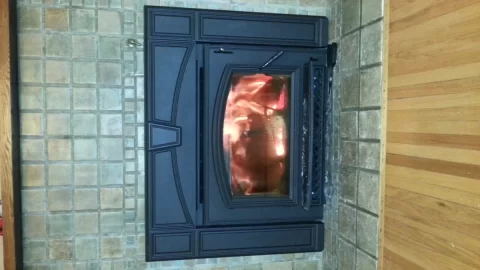

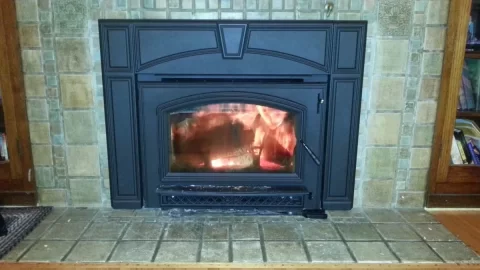

Hello everyone great forum here I have learned a lot of things. I had a Quadra Fire Grand Voyaguer installed recently and I really like how it turned out and runs. It has about 30 feet if ss 6 inch flue in an exterior brick chimney with a insulated block of plate. The first couple of fires I had were a learning experience for me as I had never burned e/w before, it took me awhile to learn how the insert liked to be loaded.The same goes for the air controls it took me awhile to figure out what settings to get an optimal burn. Once I figured it out it burns like a champ.I don't use the acc as I haven't really needed it and I found It didnt really make that much of a difference on start ups. The heat out put is very good with the blower on medium high. It can heat my older brick house and keep the temps in the 70's with it being -10 here in MN. My only complaint is the fan. I wish it was quieter. It pumps out a lot of heat on high with a roaring fire but the fan is pretty loud , I normally run it on medium where it is quieter. Overall I would rate this insert a 4.5 out of 5. pros: nice design, quality construction, large viewing area, good heat output.
cons: fan is loud on high and acc is a unused feature for me.
here are some pictures of it [Hearth.com] Quadra Fire Grand Voyaguer Review [Hearth.com] Quadra Fire Grand Voyaguer Review
here are some pictures of itView attachment 125664 View attachment 125669
