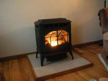

Hey all....here is some indoor pics of my install...the back is from the top looking down and from the side angle. I'll enclose outdoor pics in my next post....

Heres some outside pics...of our install.

very nice
ICC pipe?
i would like to see 6" to 12" pipe between the cap and the 90 to get the cap away from that nice siding
That's a nice clean install! I agree with Rod - that extra foot of horizontal run away from the siding would be good. My uncle's stove caps off about a foot from the side of his house, and it's pretty discolored from soot/smoke.

Well...not exactly sure what u mean by ICC. I do know its a pipe they like to use ...it has a heat resistant silicone gasket on each connection. I agree on the siding. I spent enough on the stove etc...I plan to extend at a later date...possibly doing it myself. The dealer I bought it at has had their demo's hooked up at the store for some time...occasionally switching them out and they have soot....hopefully I wont. But....it is on my mind to extend. Until then...I guess I'll be cleaning periodically. lol
I thought it was a clean one as well. Also Rod was right on with the lady that was questioning her "omega" install...he estimated an hours job to install...her install was approx. the size of mine....it took them approx. an hour and 15 min. or so.
Rod gives alot of great advice here...."hopefully" I wont have to ask to much LOL

I really liked the inside gaskets -- no caulking. I have some smoke that comes out the bottom of my (Simpson) cleanout cap -- but only at startup. Plenty of smoke goes up but I think the cold air still pushes some down before it heats up. This new pipe cleanout cap that I saw just seemed like it would have a tighter fit. I have a five foot vertical run -- no leaks in that run just at bottom at cold start up. Be nice if it came in black!

This is what they make paint for.
We NEVER buy black pipe pellet or gas
it cost a lot more and you have to repaint it anyway
so we only buy the galvanized stuff and paint it to match the stove with $9 in paint insted of 150 extra for painted pipe

Pipe on the inside
Stove bright stove paint or any other high heat paint
the pipe on the outside can be painted with house paint.

I was in a hurry and it would only let me post a certain amount of pics....looks like someone moved it :) Thanks on whoever did :)

nice setup! Is that the AE model?
No....its the Castille Model.....the AE model is just a bigger version of the Castille model. I didnt need the larger model for the space i needed it for. So far so good....love the stove!! :)
AE just stands for Advanced Enery, the larger stove is the Mt Vernon AE. I hope that some day they will make a Castile-AE.

LIttle brother in looks only .. the DNA is completely different. Great install by the way.
When I had my old stove I extended 6" away from the house at the 90 degree just before the cap. So it ran about 4" away from the siding up 6' and then jutted out at the top.
Thats correct....the AE has better DNA lol. The AE can burn a variety of fuel....Castille is limited to pellets and shelled corn.
