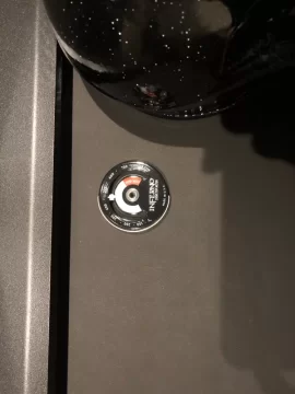

Condar makes decent stove top thermometers.
http://www.condar.com/Stovetop_Thermometers.html
Also what I’m using

I've moved the stove-top thermo to just a few inches ahead of the chimney. I've also been closing down the lower air intake (on the QuadraFire it's called the ACC system, I believe) and have really noticed a much more manageable burn. Temps don't run NEAR as high, the wood seems to last a good bit longer, and the wall temps are MUCH better. I've hit mid 140's...but nothing like the 180 I was seeing. I feel so much better about all of that.

I have a Quad. Isle Royale. Love it. I also found the same thermometer that you have was way off.....even when moving it around the stove. I rely on the IR now. As to temps I agree with Begreen, run it a bit hotter. tough to keep the glass perfectly clean but I find if I can get it to 6oo during a burn it will keep it relatively clean.
