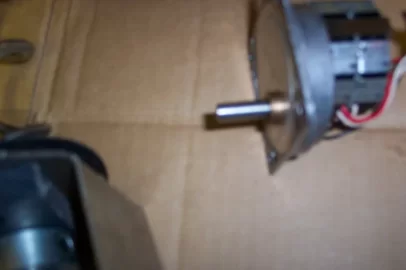

I have a 2003 QuadraFire 1200i and am hoping to get a few things clarified. Sorry to beat the poor ole auger to death, but I'm just not totally clear on the workings of it.
1) Should the auger shaft turn by hand? Is the brass part at the bottom of the auger motor that the shaft runs thru - is it a bushing? If so, is it (pic below) replaceable?
Having some issues with the auger and expect to order a new auger motor Monday, but would like to better understand the workings of the unit. Although I did speak with a QF dealer they didn't provide any real information and seemed unsure about it. You can look at my prior thread on the auger noise, but just FYI; Auger unit very clean (but cleaned it anyway), bushing/set collar/curly shaft seem good and spin freely by hand; however, will not turn when attached to the auger motor shaft. Have always sifted the pellets and cleaned the stove well, but was truly amazed at how clean it appeared. I have a thread running on this but thought of these questions later and think most folks have "been there done that" so not answering

In general, if the auger is disconnected from the motor, and the auger tube is clear, the auger itself should able to be turned by hand.
As for the ignitor, if you want to use the ceramic nuts, just clip the quick disconnects off. IMO, you should keep the quick disconnects and put the matching connectors on the stove wires.....makes removing a cinch.
As for the bushing, I can't help there....hopefully a CB1200 owner will see this thread and comment.
