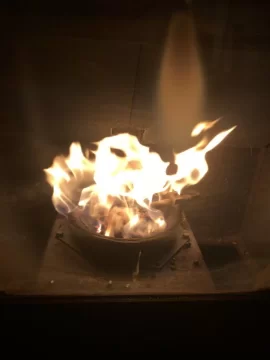

QuadraFire classic bay 1200 fire pot filling
Without a firepot gasket, a lot of the air is going around the pot, and not thru it, which will cause a lot of issues. Also you never said if you re-adjusted the feed rod. kap
I guess that’s my next step. I’ll have to get a gasket tomorrow, I’m sure I can’t find anything like this at Lowe’s. I’m gonna have the guy come tomorrow or Tuesday. I can’t sell the stove like this. I wouldn’t want somebody to do this to me. So hopefully I have bad airflow bc no firepot gasket. Makes sense?

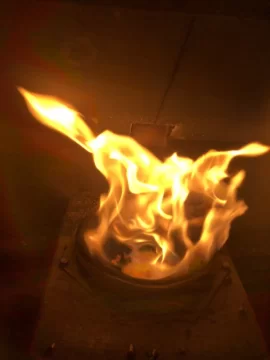

Pics help a lot. So you think you’re missing the main fire pot gasket. That would be very surprising. You bought stove new or used. It’s a 2015 correct?
Im definitely missing the gasket. I took it out to clean it before the season and never replaced it. Think that’s my problem? I’ll get some pics later

[Hearth.com] QuadraFire classic bay 1200 fire pot filling This is my flame after 7 or 8 minutes of the stove started

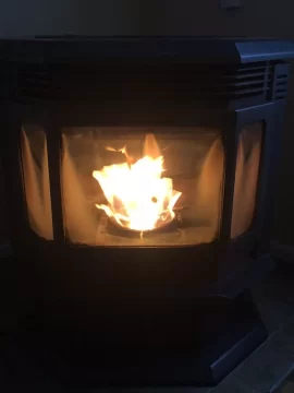

Omg inside the house? Lol i bet you did have a mess. Im betting there is somthing in the vent pipe or combustion motor is weak along with the gasket. What is you vent configuration?
