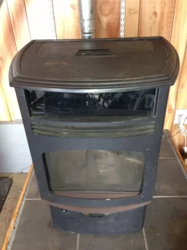

Just picked up this Contour this AM.

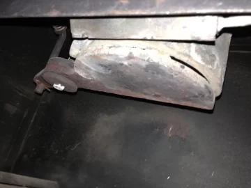

The only thing wrong is the bottom plate in the fire pot falls down and does not make a good seal.
Anyone know a good way to fix it? The bolt seems frozen.

Pull the place , wire wheel it. Snug up the bolts.
Good time to up grade the bolts to.
Cut head off and install new hardware as PoolGuy said above.
