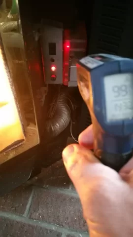

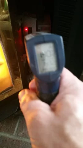

A couple of thoughts on that. You sure it is the board that smells and not that by accident a pellet bag came in contact with the glass while the stove was running? That would give you a plastic smell. Or if you have little kids make sure none of their toys are touching something. Kids love to put toys in the hopper too. Anyway, below are temp. readings taken today from my 1200i while it is going. Compare and let me know. The blurry one is 140 F.
  • [Hearth.com] Quadrafire control board getting hot.
