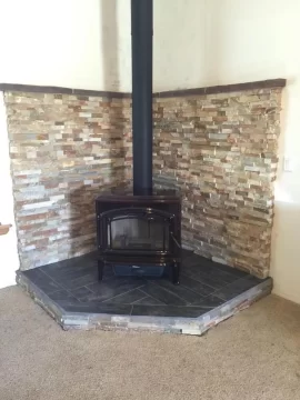

Just got done converting my propane fireplace to a Quadra-fire explorer II. Can't wait for first fire. I built the hearth and did the stone work myself. Looks gorgeous sitting there in July :). Will have to update this as weather cools....

Looks great! I installed my explorer II last summer and got a full winters burn out of it. I was pleased with the performance for the type of wood I used. I used mostly oak that was seasoned for one year and I stopped using that around Dec. and switched over to eco-bricks. The wood was still just too wet and I was tired of fighting it. Lessons learned I guess. Good luck and let me know how it rolls!
Nice install.Did ya do the rear vent install?If so how good is your draft?Do ya have any other pics of the back of your stove or chimney setup.We are going to be building a new house and the wife doesn't want to see the stack coming from the top.I Was thinking of building a stone hearth and having rear vent setup going up an interior chase.
The draft is good. I did not do the rear vent install and I am going up and out vs. going straight out the back. I actually prefer the look of the stove pipe coming up from the stove. Here is a pick of my install. The stove that is shown in my avatar is from the showroom where I purchased the stove. https://www.hearth.com/talk/threads/new-quadrafire-explorer-ii-fired-up.133574/
Nice install.Do ya have any protection for the walls next to and behind the stove?I really like the look of the explorer.How well is it performing with burn time.I live close to one of the largest quad dealers in the country.I have looked at the quad two and three.I was quoted 2371 for the quad three which I think is a great price.I would install something similar to you but my wife hates the look of the stack going up and out.We are going to make some sort of masonry fireplace and then use the fake stone stuff above that to conceal the class a pipe.thanks for sharing.ps the 2371 price is for black was 2571 for enamel coating
That sounds like a good deal. I was able to take advantage of the quad dealer state fair and saved an additional $750. So I was able to get the enamel. I don't have any heat protection since I am exceeding the recommended clearances by at least 4 inches on all sides. I decided on the pipe going up and out so I could get as much draft as possible.

Update: so the we are a full year later. Burned one full season. Went through almost 4 cords of wood, maybe 3 1/2. About 1/3 ponderosa pine, 1/3 pinion and the last 1/3 a mishmash of juniper, quaking aspen, russian olive, oak, birch, Doug fir, and a little of I don't even know what. It heated our 2200 square foot house just fine. We were toasty all winter long. The explorer III would definitely be too big for our house. At times we would even have to open a window because it was so warm. But in the back of the house where our bedrooms are it was absolutely perfect sleeping temperature for us to our liking. About 70-72° when it was 15° outside. Just got the chimney swept last week and they said there was only about 1/2" of light, gray, fluffy soot. They said that was just what you want to see and sweeping it once a year was all I needed. I am 100% happy with our explorer II. :)
Good to hear that it's heating well Jeff. That's a good looking stove. How often were you reloading in cold weather?
