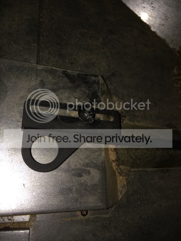

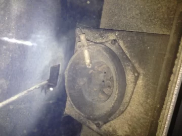

Take a picture of your burn pot showing where the thermocouple is.

I'll try that too, thanks. I'm still wondering about the position too though, is it 3/4 from the edge, or 3/4" into the center of the pot. A pic would be very helpfull for me, the directions aren't real clear
[Hearth.com] Quadrafire first fire
Here you go
Thanks, mine is pretty close to that. I'll check the thermocouple inside the housing.
