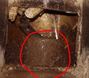

So I took a pic up the chute for the heck of it. Could anyone explain what the circled object is? Is this normal or should I be able to see the rest of the auger? Thanks.

At least on my Quad, there should be nothing there. It looks like half of your drop area is blocked by some nasty looking 'stuff', which would explain why it doesn't feed enough. If you get a few long pellets (another common cause of poor feeding) bridging over that area, your feed rate will suffer. Get up there with a long screw driver and see if you can knock that loose. It almost looks like a chunk of fused pellet dust that got pushed up to the end of the auger and is just rotating around with it now. I've had an aluminum safety plate mashed and pushed up there as well as a Hot Wheels (not mine). :) You might have found at least one of your problems.
The fact that you have 4 year old pellets makes one wonder just how much the previous owner used the stove and if he had problems like this that he just gave up on.
That pic looks like the top of the auger assembly. All looks normal to me. They use that shaft to have support to weld the feed spring to. I agree on the old pellets. Get those worked out and you should see some improvement. I would also think if your ash dump plate was too far down, you should be getting incomplete combustion.
Is see that your feed motor is on the top while mine is on the bottom. Wrong - mine is on top too but it sure doesn't look nasty like that after 5 years. Perhaps that 'blob' is a weldment but everything up there looks nasty. Like it hasn't been used or cleaned in years. It's definitely time to pull the auger. It almost looks like sometime in the past there was an auger tube fire or close to it. You should see the end of the auger where it meets the output of the motor.

I am looking at the pix up the feed tube ?????????????????????
Something looks strange.
Get the hopper clean down to the auger entry point and clear it well.
Get us a pix of the entry to the auger tube inside the hopper.
I am very suspicious that there is something in the top of the auger tube that does not belong there.

I think a got this thing scoped out.
You have something stuck in the auger tube.
Here is a piccy looking up my Quads drop tube (Real groan to get a view up there)
Notice that you can see the feed auger (Spring) in this piccy, and yours has something blocking the drop tube.
Get the hopper cleaned out completely and remove the auger. (Take top off stove and auger motor is right there)
I suspect what is blocking the tube is the feed gate.
Possibly long before you were its master the gate fell into the auger and got pulled up to the top of the tube, blocking the port.
Once the auger is out and the tube is cleaned out, whatever is in there should fall down to the bottom, or be easily poked back down.

This is the full size pic up the feed chute. When I get home from work I'll work to empty the hopper and see about getting a pic from the top.
I did stick a long screwdriver up there but whatever that thing sticking out is it's not moving with just a tap of the screwdriver.

Is the first piccy you posted looking into the hopper ???
If so then the feed gate is nearly closed
snowy's pic has the very end/top of the tube obscured.
*but* if that cylindrical piece of metal isn't supposed to be there (on
QuadraPelletNewb's), then perhaps it is some sort of kluge/jury rig of a different part or repair/joining of auger to the mount.
i'm just speculating from what i can and can't see on those pics.
seems to me the question is, is that bit of metal supposed to be there.
it seems reasonable to think the screw should continue over that whole opening.
again, i'm just spitballing here.
I agree
That piece of metal is closing off the port.
Things need to come apart to see wassssup

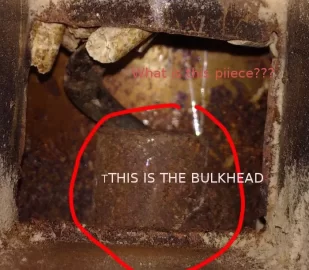

I am still suspicious that the metal piece in the one pix is not supposed to be there.
YUP
Just the same as my 1000
I wrote on the original pix
The part marked with red text.
WHAT IS IT

Are you sure you have the feed gate fully opened? With the hopper lid open, pulling it out (towards you) opens the gate.
That is the mystery. The last pic I posted was the same angle/location as yours Snowy...up from inside the firepot. The one with the circled piece is the exact same pic just zoomed way in.
Well, I have pulled it up as far as I can in the hopper. Could a piece have broken off? Perhaps. I know this unit is 12 years old...but I find it strange that these internal components are so rusty/oxidized.
