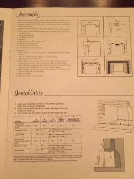

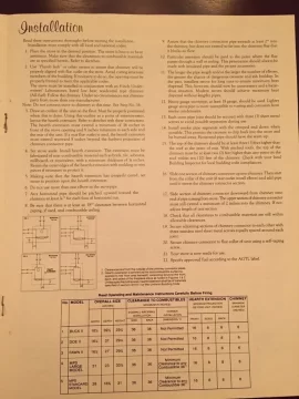

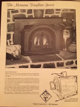

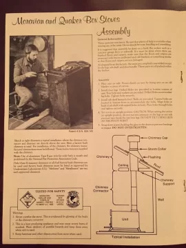

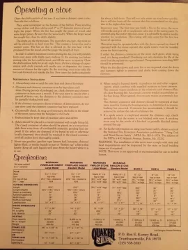

Came across an older Quaker Moravia fireplace insert and I got a good price on it, good enough to stick in my den.
But the real find was the original owners manual which looks to be from 1981 or 1982. It covers several models with pics and diagrams. Models include the Moravian, Quaker Box Stove, Buck II, Doe II, Fawn II, Moravian Parlor Stove (both large and standard).

that is cool but make sure you dont follow those instructions and install it without a liner from the stove to the top of the chimney. That is no longer and acceptable install method

Thanks, wasn't planning on it. I'm making an adapter to reach my stainless flue liner, which runs from the top of the smoke chamber to the top of the chimney.

good some people still want to just shove them in the opening with no connection.
