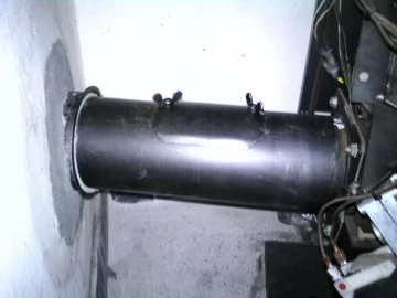

Hello Neilt, and welcome to the forum. In 2008 I was in a situation much like yours. My stove is also a Quest Plus vented in an old masonry chimney. See photos here of my flue and house with the 60 feet chimney. I live on the third floor right under the roof.
[Hearth.com] Quest plus burn problem [Hearth.com] Quest plus burn problem
From reading here at Hearth.com I learned llttle by little how to maintain and tweek the stove for best performance and these days it runs like a charm.

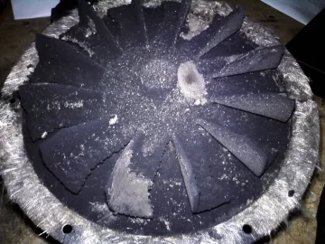

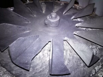

Now, my living room is quite small, so the stove mostly runs on the two lowest settings. This makes the stove soot up quickly, so in my case a deep cleaning is necessary twice every season. These pics show the impeller on the combustion blower before and after cleaning. Note: My scrapings in the soot layer clearly indicate the chronology of the burn characteristic as the soot layer builds up... the innermost layer right after cleaning is light greyish ( = good burn ) and the outermost layer is dark and sooty ( = bad burn ). After each deep clean it burns like a brand new stove with a draft so violent that the damper needs to be pushed in a bit.

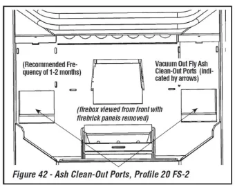

BTW. the modification ( ash clean out ports ) suggested by forum member Ricks is something I am planning to do in the future, as it would make cleaning of the "exhaust manifold" much much easier. Ricks states that Lennox will be helpful, if we contact them on this matter, and that is what I intend to do. The Profile 20 is the stove that succeeded the Quest Plus and the Profile 20 ( of the second generation ) is built with these ash clean out ports, as we can see here:

Thank you all for the help. I cleaned used the leaf blower today as I only have to move the stove 15 feet to be outside. The stove works great now. I found my big problem. Thanks to the pictures from stovensen, I noticed the fan did not look the same as the one I had pulled and cleaned. When I pulled the fan out, there was a mouse that was in the exaust. He must have been in there when I turned it on for the first time. As I said the house was vacant, and I just purchased it. Anyways I finished the rest and it is getting plenty of air now. So now it's off to search this forum again for the fine tuning of the stove. Thanks again to all of you.
