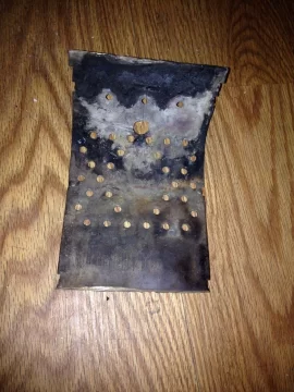

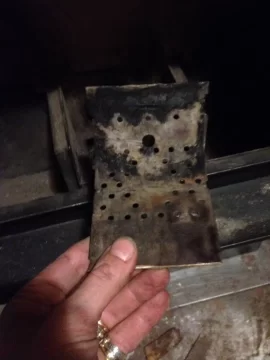

For those of you that keep asking about the modified burn pot ...... I'm not making it for others at this time due to testing and changes that I am still making.
I'm testing the air wash mod -- hence this being prototype 3 of the burn pot. I've enclosed pictures here so that those of you can see what I have done. And for those of you that want to make your own, you can use these as a base template etc.

Thanks You for the pictures..... my buddy has a machine shop and is good with this stuff we may play around a bit over the winter and see what we can come up with..... Like I said my stove is running a ton better but I'm screwed now if I can't find softwood pellets so I'd like to make something that would allow me to run both...... But for now this is working so far
