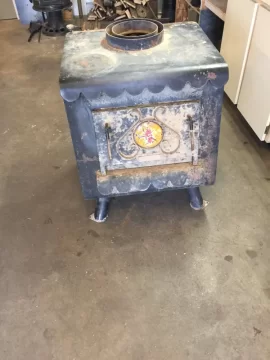

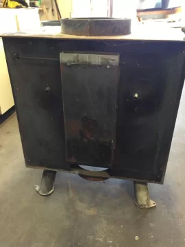

Hi, I have another project I am working on. I went to the recycle steel yard and this wood stove was sitting right there for the taking at 20 cents a lb. It was less than $80.00 as I had to also pay for the weight of the bricks. I did complain but to no avail. I am not wanting to identify this stove as I found some info on it from searching the internet. But what I can't find is how the coil works to adjust the air intake on the back side of the stove. This stove still has the coil which was connected to the rod hooked to the flapper on the back. But everything else is gone. I know this is a long shot but was hoping someone might still have one of these Earth Stoves and could send me a picture of how the bio-metric coil hooks up on the back.
Is someone with a sharp eye might notice that this stove have a handle on it on the right side it is because this is the Earth King as I put a damper inside.

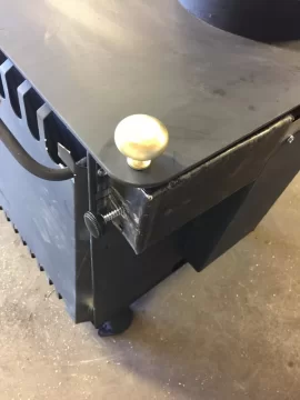

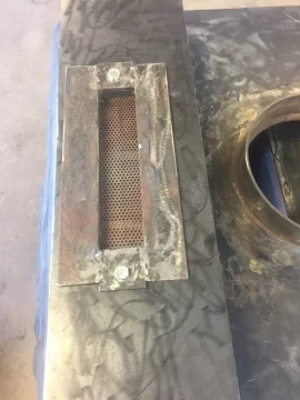

The box on the back of the stove is homemade. But you can see how the coil is just hanging out in the open. I did attach a knob with a spring tension but not sure I did the right thing. Hope someone can help with this. Thanks

The model 100 had a 3 position knob / lever that tightened and loosened the bimetallic spring that was connected to a rod that went down to door flapper. It should of course be fully open when cold and adjust to close at desired low temp, like 250 on pipe thermometer, 300 medium, 350 -400 high. With it cold, you should be able to close the damper flap by hand, pulling the spring tighter. As long as you can close the flap it's safe to start and adjust from there. You may have to put a weight on the flap like a clamp or vice grips to hold it shut enough to prevent overheating until you get it right. I don't know what friction device they use to keep the knob in position. That shaft must be held in position so the spring moves the rod and flap, not adjuster shaft. May have had detents on the lever, other t-stats by others have a friction control inside to prevent the control shaft the spring is mounted on from rotating out of the set position.
[Hearth.com] Question about Old Earth Stove Air  IntakeFriction control on left.
coaly, Thanks for the picture and your comments. When I built the box for to hold the knob and to fasten the bimetallic spring. I welded a small nail to the inside of the metal box on the outside part of the bimetallic spring as the other end is already attached to the rod as shown in the picture. I set in in position so that the flapper was fully opened. When I fired up the stove as soon as the stove heated up the bimetallic spring closed the air intake flap. I have a spring for tension on the knob shaft but it was not strong enough to hold open the air intake flap. What you said about the friction device is my problem.
When you say three positions for the heat control does the knob click or can you feel it snap into each position?
I might have to dream up some other ideas. I believe this stove is a 101 as it has the round ceramic tile on the front.

I don't think any of them clicked in place. But it has to remain in place to make the flap move instead of the shaft turning. A Dual Heat used by Hitzer has a gear reduction from the turn knob shaft to the shaft connected to spring. That way as you rotate the knob the movement of the secondary shaft is very little and doesn't turn the knob shaft easily. Never took one like yours apart. Maybe just a spring with a loop around the shaft pulling sideways to prevent it from rotating freely? If the loop or hook on the end of a spring isn't enough, due to very little contact on the shaft causing friction, a wider area like a pipe strap made into a loop around the shaft will increase friction preventing easy rotation. Just don't lubricate it. They are a simple mechanical device. European stoves use an oil filled capillary system with dampers and dashpots that are much more accurate, but like the rest of the European stoves are far more complicated.

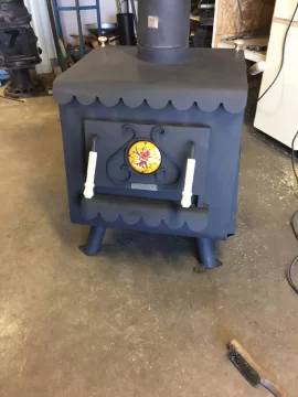

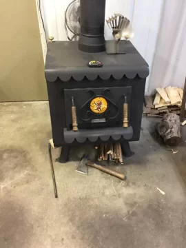

Just wanted to post an update on this Earth Stove. I call it the Earth King because I put a damper inside like what was in the Blaze King, I posted on this forum some time back. I dreamed up an idea for a combustor so tried it out on this Earth Stove. I did not mention it earlier as did not have cold enough weather to put my newly designed stove to the test. It was rainy morning so I fired up the Earth King and ran it most of the morning until the sky cleared up. The combustor is made out of perforated stainless-steel sheeting. I think it is 20 gauge not sure what size the holes are. The picture shows my set up before I welded it inside the stove. It measures 2 inches by 8 inches and is designed to unbolt just in case it didn’t work. There is about 10 layers of these small panels with spacers between each layer for better air exchange. (see picture) Inside the wood stove I welded a ¼ plate about an inch above the combustor so it would spread the heat rather then get the top of the stove to hot. Again, this idea comes from the Blaze King. There is also a secondary burn tube set up before the fire goes into the combustor.
Today I was able to burn a few small logs with some scrap pine lumber for about 5 hours this morning. When my homemade combustor started working, I would get white smoke and sometimes no visible smoke from the stack. The stove ran at an even 350 to 400 degrees for about two hours until it needed a few more pieces of wood. The wood stove was putting out a nice even heat. I don’t know how long the combustor will last but the stainless steel should last for a long time. I would like to try this again using ¼ inch hole perforated stainless-steel sheeting.

You're probably seeing steam, not smoke. Tremendous amount of water vapor formed from combustion.
Two matters to consider.
1) Manufacturer clearances will not apply because of the modifications made to the stove. So, if you are able to get it back to the original specs, you can comfortably use the clearances to combustible in the original manual. I did run across a shop in TN that had lots of old Earth Stoves on display (historical) and I did not ask if they had any parts. You can send me a PM if you want the contact info,
2) Be careful on the rationale behind having heavy steel plates near the front of rear faces of the combustor. Excessive heat will destroy the wash coat with excess temps, essentially removing the precious metals and wash coat applied to the metal substrate. And just because the substrate does not collapse (metal vs ceramic), once the wash coat exceeds 1600F, the goal of the combustor is defeated.
Good luck, be safe!
BKVP, thanks for sharing our concerns. I posted this update about my homemade combuster because it always brings in other info which might help me in the future. I have the stove in my garage and only need to worry about the clearance on the back side. I think I have about 20 inches of clearance with corrugated metal sheeting screwed to the sheet rock. But I am going to change this so it has some space between the metal an the Sheetrock so that air can flow between the two surfaces.
I put 1/4 plating about an inch above my homemade combustor to protect the top of the wood stove. I will find out more when winter comes as stove season is pretty much over here in my area. The Blaze King I had with the combustor had very thing steel plate above the combuster so was thinking 1/4 is better. Plus I had some sheeting left over from working on other stoves. I will try to keep an eye on it. Always appreciate input from those on this forum.

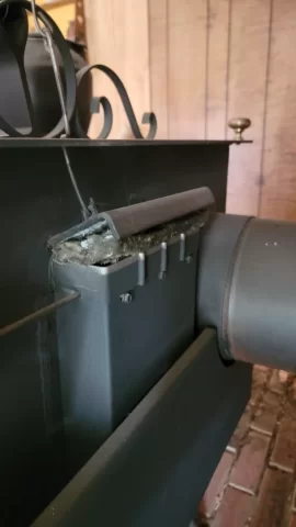

I have a similar one but want to ask about the intake vent.
The lid that closes on top of the intake, do you have a supply point for that felt like gasket?
On mine it's like a 2" x 6"~ cottony (probably asbestos) filliment pad. Nothing like the door gasket

I would cut the gasket out of a thin mat of ceramic fiber and would use a thin coat of RTV silicone to adhere it. This can be found on Amazon. Search for:
Lynn Manufacturing High Temperature Gasket Paper, Superwool, 2100F Rated, 1/8" Thick x 7" x 10", for Wood Stove, Pellet Stove, Boiler, Furnaces, Kiln, Forge, 2260J​
