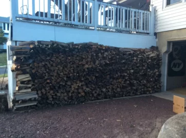

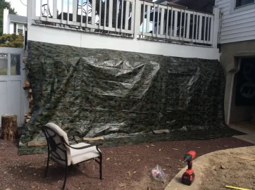

I have a drying station, a holding station and a using station.......
The drying station is single racks of newly split wood, sits in the sun and wind uncovered til it gets to 20% MC or less! then I move it to an area under a deck, this is not top covered either. Then in September I fill my using station, very soon I will be tarping this wood so that it stays completely dry throughout the winter. This particular area gets a lot of wind so the tarps do not hinder the wood from getting damp.
Personally I would never cover wood unless you need to keep it dry so that you can use it. This works well for me. I am using 3 year old red oak that is at 12% MC this year....... [Hearth.com] Question about wood covers[Hearth.com] Question about wood covers
