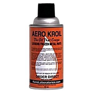

See if you can find Kroil at a local shop and spray that on the nuts and let it sit overnight. That stuff is amazing at getting rusted bolts off.
