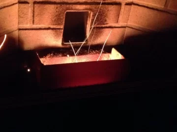

My Ashley AP5660 on 5 (max setting) has reached over 630F. -- Burn pot glows red at this temp as shown in the picture below.

These readings may not be exact with the IR gun, I just use the readings as a ref point when checking the stoves performance and when I feed it new / never used pellets.
The outer casing of the flue has never got / gone above 300F before going out the wall.

Did you shoot the glass or the metal? And you're talking internal temps. Remember, Harman monitors exhsust.

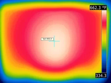

Measured my 10-CPM with my Flir IR camera. I was never able to determine the exact emissivity of a flame nor transmissivity of the ceramic glass, but this is the reading I got assuming 90% for each:

I just shot 818::F with door open.
Pics or it didn't happen! I could try that although the flame gets instantly lazed out when I open the door. Also, with the lack of fresh cool air drawn across the flame might effect it's temperature. What reading do you get through the glass?
