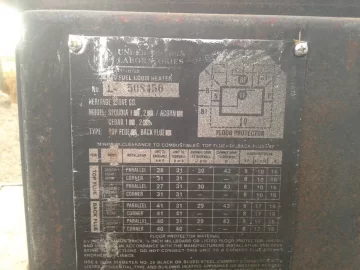

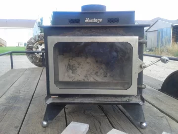

I've been looking for a good, used wood stove to heat a pole barn I use in the winter as a wood shop. I found the stove in the pictures below and interestingly, I've searched the web high and low for that model # 508450 and haven't had much luck finding anything helpful. Admittedly, I know very little about wood stoves as I've never before owned one. This stove has been sitting in a garage unused for many years and it does have some surface rust, but it appears to be very solid and all the welds seem to be in good shape.

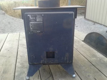

My questions are 1)Does anyone know anything about this particular model?; 2) anything in particular I should be looking for to determine if this stove would be a good purchase or one to avoid? 3)what would be a fair asking price for this stove? 4) on the lower back side of the stove, what is that square cut out? It obviously had something screwed onto the stove here at some point.

Based on the rear tag this appears to be a Heritage Cedar 2. It's an old pre-epa stove by the looks of it. Worth maybe $150? Does it have a baffle? That will help it be a bit more efficient. The hole in the back most likely is where the blower attached. Check Graingers for a fan that has a flange and outlet about the same size.

Thank you for your reply, begreen! It does have a baffle. In your opinion, is a pre EPA stove one I should avoid?

It should be ok for a shop stove, not very efficient, but ok if you only burn fully seasoned wood and don't let it smolder.
Two caveats - it looks like it takes an 8" flue which will be more expensive than 6" which is more common. Smoke pollution is a sensitive issue in parts of Utah. If you live in a valley or near a city in Utah then check to see if it is legal to burn in a pre-Epa stove.
