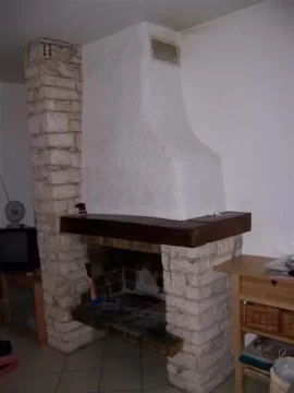

Hello,
This website has been great. In fact, last October, I used the main part of the site to discover how to build and manage a fire when we moved into a place with a wood stove. (My first time using wood as the only source of heat!) This website was a lifesaver! I have now just recently spent almost a whole day reading every "question and answer" page, and then many posts in the forums to try and get information about a question I have. (Hence this post.)
We just moved into a new apartment, which also uses wood heat. However, the new apartment has only a single large open fireplace (see attached photo). I know an open fireplace is a really inefficient way to heat the apartment, which is why I'm thinking that maybe it's a good idea to somehow "convert" it into either an insert or a wood stove.
(Our landlord has given full permission to do whatever we want, as long as we don't physically modify the existing fireplace, and we take whatever we install with us when we leave.)

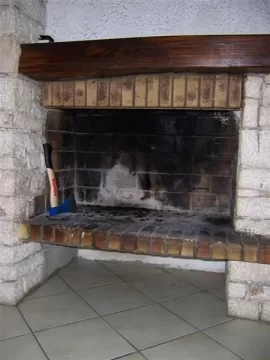

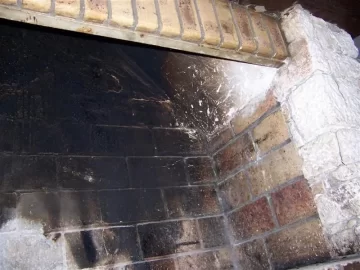

I've attached a picture of the fireplace (attached pic "1.jpg", "2.jpg", "3.jpg"), so you can see what we have. The hearth is 39" wide by 23" inches tall at the opening and is about 20” deep. (It's about 27" deep from the very rear of hearth to very edge of the brick in the front.)
The room in which the fireplace is located is the main family room where we spend all our time. It is 309sq ft (with 8.5ft ceiling) and our whole apartment is 650 sq ft on each floor (2 floors total).
We live in a little village in the top part of Corsica, France (the little island in the Mediterranean right below France). It only gets down to about 40 to 50 degrees for maybe 4 or 5 months or so. It's often very windy, however, and our apartment is definitely not very airtight. (Every window/door leaks.) The walls are about 1.5 feet thick (made of brick with stucco on the outside and plaster on the inside) with no insulation. The doors/windows are double-panned glass. Yippee.

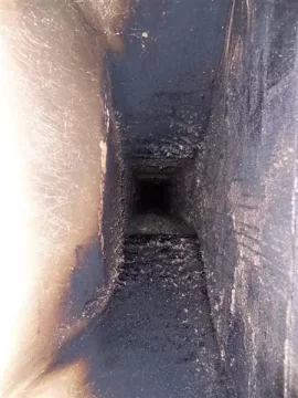

The chimney flue is approximately 9" x 9" (and totally covered in black creosote) that goes up 2 floors straight out the roof. (See attached pic "4.jpg" for a shot looking straight up the flue.) My understanding is that for either a stove or an insert, we will need a flexible stainless steel chimney liner that connects from the back of the insert/stove and then goes at least 5 or 6 feet up the chimney flue.
I'm thinking about also adding an additional section of rigid stainless steel single-walled liner to the top of the flexible portion, as I've heard it will be better to run the tube as high as possible. Do you think this is a good idea? There's no access to the roof, so I have to do everything from the fireplace opening. (And cleaning will always need to be from the bottom.)
It's worth noting that there does not appear to be a damper or smoke shelf when I looked up the flue with a flashlight. The flue just goes in a straight line all the way to the top, with no obstructions or anything. Incidently, the flue is in the middle wall of the apartment, and not along an outside wall.

Wow that chimney looks like it is in desperate need of cleaning, I'd be afraid to use it with anything till that thing is cleaned!
Ya, I'm dreading the conversation with our landlord, as I kind of think he should be responsible for getting it cleaned. We just moved into the apartment 3 weeks ago and have never lit a fire... My French is also very horrible, so the conversation is likely to go badly.
I'll probably just ask one of my cousins for a recommendation for a cleaner and if it's not too much I'll hire someone. (I'd try and do it myself, but I've never done it before and also I think it's abnormally dirty so I'd rather have a pro do it, as I don't want to mess around with my family's safety. After it's cleaned the first time by a pro, then I'll tackle the regular upkeep and yearly cleanings myself.)

Kind of a strange looking fireplace. Can that elevated fire shelf support the weight of an insert or stove? Might have to put something underneath for support. Also, the mantel clearance could be an issue.
Just thought I'd give you a little perspective on size (and I agree with Elk on stoves) My Osburn 1800 is loaffing along right now. A hot bed of coals, blower running on lowest setting, and been running so low today, I think I put around 10 peices of pine in today one at a time. House is 2200 sqft colonial sort of thing with stove in one end of the house. Whole lower level of the house is about 80. Windows were open earlier. Outside temp is 43.
I could easily drop a bunch more wood in there and get that stove cranking a lot harder. So you'll be surprised how much better a stove would heat your place.
In looking at the pictures again, I have to agree that if you could put in a block off panel in front of that fireplace and have a nice cast iron stove like a Vermont castings or a Morso in front of it you'd have a nice heater. That fireplace is quite odd looking. I'm surprised it doesn't smoke like mad. What's the little vent at the top for?
I don't dare use the fireplace as it is, so I haven't a clue if it smokes. The previous tenant said it worked really well...
I don't have a clue what that little grill at the top if for. In fact, I was going to make another post about that later. There are a few other little holes, too. One little steel door right to the left of the open hearth (right behind where the axe is located, if you look closely). And there's another little screen opening maybe 3"x3" on the outside of the left pillar right down by the floor. (Can't see it in the picture, but it's covered now by the furniture holding up our TV there on the left side.)
Very strange... some kind of ventilation I suspect.
