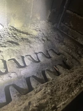

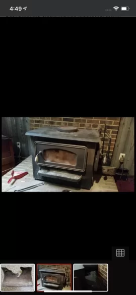

Thanks for the reply, yes I have read all available forums that I’ve found and it seems none of them are related to the exact stove I’m getting. It’s in great shape and only been used when the power went out. Seems like Treemont didn’t stay in business long. It looks really well built, it has glass door in front and side loading door, shaker grates and a removable ash tray underneath. I’m guessing it can be used for coal or wood. Also has a blower that works. After looking at it again I think it the flue can be used top or back because it has a dummy type plug in the top right now that can be removed with bolts from the inside. Thanks again
The photo below is not my stove but looks exactly like it
[Hearth.com] Questions about Treemont free standing stove
I found this on u-tube and I also found one on ebay but can't find it now--that one was a strange looking stove--lol I do not think that people who never owned this stove does not like them and maybe wholly outdated and the company no more..Here is u-tube..
coal stoves are different from wood stoves; the shaker grates I see in the pic from that youtube vid indicate it's a coal stove.

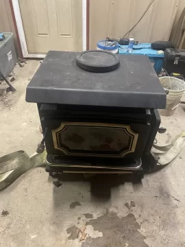

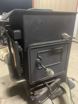

Mine is almost exactly like that except for the hole in the top of mine is round and 8 in same as the flue in the back. Here’s some pictures of mine. Thanks for the help. I picked it up cheap so I’m gonna try it. Thanks again

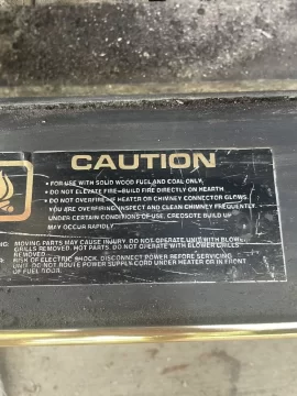

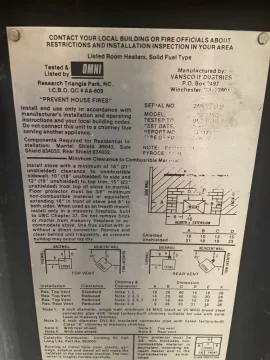

I can’t tell for certain but I think the tag says fuel type solids

I can't say; both wood and coal (and mixed) stoves are solid fuel stoves (i.e. not gas, oil, or electric).

The people I got it from claim it heated real well and wasn’t a wood hog. I currently have a unknown brand that looks like a momma baby bear. I have to add wood about every 4 hours and hoping with this one I can at least get through the night on a box full of wood![Hearth.com] Questions about Treemont free standing stove[Hearth.com] Questions about Treemont free standing stove[Hearth.com] Questions about Treemont free standing stove[Hearth.com] Questions about Treemont free standing stove[Hearth.com] Questions about Treemont free standing stove[Hearth.com] Questions about Treemont free standing stove
That looks like a Treemont coal/wood stove. How does your stove feed the air to the fire? Underneath the grates? Definitely not very efficient. A modern stove would have a longer burntime using less fuel.
FWIW, We had a posting asking about parts for this model (HC3000?) a while back.

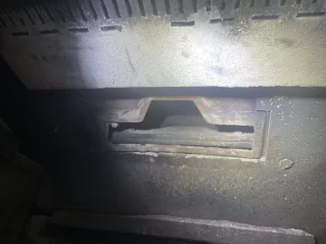

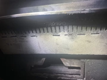

It actually feeds air in above the front door, it’s a crazy design. I think they tried to make it either or with coal or wood but like I’ve seen in other posts that doesn’t work very well. Thanks

I’m going to try it, don’t have anything to loose. The only place I can find that air can enter is above the front door. Thanks again for all input and hopefully I can help someone in the future

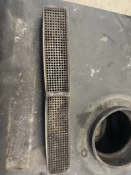

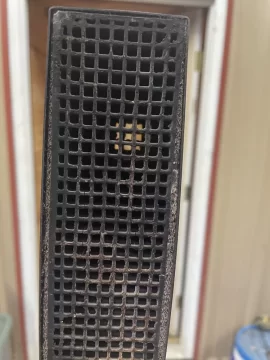

One more question about catalytic converter, I know this one is old and there’s a couple of small broke pieces but it’s not stopped up or brittle any chance of it still working??

You won't know until you try. It's possible, but to me it looks rather black on one side suggesting it is coated, rendering the active (precious) metal inaccessible to the flue gases.
You may have to do an acid wash (see elsewhere on this forum) to try to get it in better shape.
Chances are, though, that it is not alive anymore. Buy another one (and gasket) so you can replace this one if it doesn't light up.
Well MarkReid96 you read my mind again and sent pictures of the combustor. I have never seen a combustor this thin but maybe some of the other stove guys could enlighten me on this. I have always seen them much thicker. I think this is a real plus to have wood stove with a combustor it will be much more efficient stove. I had a Blaze King that had a combustor that looked good and after I rebuilt the inside of the stove it seemed to work just fine. But stoveliker had made a good point as looks can be deceiving at times with these combustors as this one looks like it has had some miles on it. But you will know when you get this stove fired up.
Just wanted to add this link as I have read it before but is a good article on combustors https://midwesthearth.com/pages/catalytic-combustor-faq
