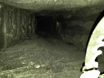

He is coming to inspect today at noon, so I guess I am out the 50 bucks regardless. I will keep you posted with what he says. Here is a pic from inside the fireplace, looking up into the chimney, but I don't know that this alone would be any help...

I Think I see a 12x12liner up there. It is pretty dirty though it will need cleaned for sure. After that I would recommend running a camera through it to check the condition of the liners. And all of that is going to cost more than $50
So, turns out it is a gas fireplace. Didn't realize those would be common in 1920.
He wants to clean it, put a cap on the chimney, and says the damper is in disrepair, so it will need fixed. For his services including the parts and cap he is quoting between 400-500 bucks just to get it in a state of repair so that the plumber can come in and install gas logs. To me this seems a little ridiculous, but looking at the cap size I probably need they run around 150 bucks.
