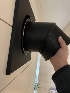

Quick: Can Class-a Chinney be flush with thimble?
Keaton85
Oct 15, 2022
2
Camden, ME
As pictured, is there a set amount that the chimney has to protrude into the room? This is all I’ve got until I attach to the double wall stovepipe.
[Hearth.com] Quick: Can Class-a Chinney be flush with thimble?
What does the manufacturer’s installation documentation say?
Sadly the manual does not specify far wall protrusions. It only specs for ceiling protrusion of 3 inches.
Anyone else have a recommendation?
Contact the manufacturer and ask them what the spec is. There has to be one
As a guess, I would say probably no due to the clearance requirements of the stovepipe connecting to it, but the class a chimney pipe mfg. has the final say.
