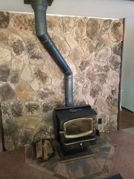

I wish I had an answer on all your questions, but I really don't yet. But I added one more pic on how it looks now, it has been working for 30 years so not sure why he would have to redo it. I just think they would replace the old pipe?
Excuse the mess in the picture.
Just because it has worked does not mean it is safe or that it even worked well
