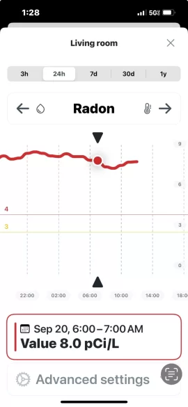

I got 2 airthings wave radon detectors. recently.
The 1 in Utah shows about 2-3 times acceptable levels in both the basement and main floor of the house. Even upstairs is way over acceptable levels. I found out everyone in my utah neighborhood is getting similar results. Some have installed remediation systems and my buddy got his levels down to very low levels from very high ones. To bad he lived in his house for 20 years before realizing he was breathing in so much radon. They have bedrooms in the basement as do many people in Utah.
(His installed system cost a little over $1,000.) And they did his from outside his house.
The NJ house basement is mostly staying in the "safe" range.
I do like how the app links to the detector and keeps the short and long term charts that are easy to read on your phone thru Bluetooth. A bonus is it also reads humidity and temps and charts them as. well.
They say it takes 30 days to get truly accurate results as levels do go up and down. But you can get a good ballpark in a couple days.

I have an "Open Window" policy now in the Utah house as i'm not a fan of sucking in radon all the time. With windows open the levels are low, but it takes less than 1 day from closing all the windows till the radon levels get back to poor levels.
I don't spend that much time there so am debating how best to deal with the radon.
Utah house Main floor reading.
