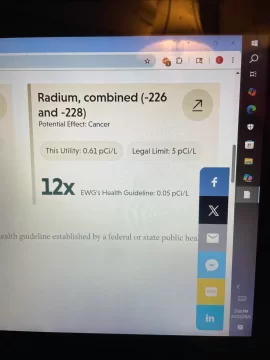

I won't be over to that house for a while. We do have a coop water co that feeds about 500 homes. I can get the water report from them.
Edit I found the report online. Data is from 2018-2023.

Are you looking for radon levels to increase because of radon in the water or from humidity?
