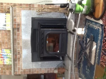

It has rails. The question is are the stands worth it... ? Do a search on this website and you will find owners that built their own of wood or metal. To purchase from Harman, the stands are about $275. Either way, I can't imagine cleaning behind the stove without the stand.

Rolling it on pipes is a good idea. I have to think about how I could set this up with my insert. Right now I use 2x4s screwed together to make an "L" as supports to slide the stove out on.The 2x4s fit perfectly in the slots on the bottom of my stove. I've also used a small car hydraulic scissor jack to support and tweak the height of the stove. The tweaking of the height makes it a lot easier to slide it. I don't know if it is a pain for everyone with an insert to slide the stove out and back in again but it is for me. If the Harman official product makes it easier then it might be worth it assuming a similar things couldn't be more economically fabricated. Unless the cost was not a consideration, of course.

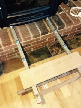

[Hearth.com] Rails worth it? - accentra 52i I made my own using a couple pieces of square tubing - salvaged from an old bike rack - on each of which I mounted 3 roller bearings. I position these on the hearth with the other end supported on some wood blocking. My stove almosts rolls out by itself.

View attachment 166628 I made my own using a couple pieces of square tubing - salvaged from an old bike rack - on each of which I mounted 3 roller bearings. I position these on the hearth with the other end supported on some wood blocking. My stove almosts rolls out by itself.
Simply elegant. I have to try this.
