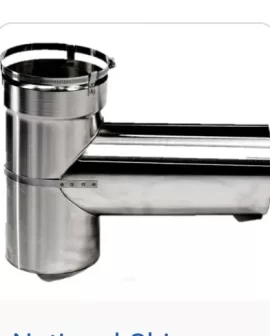

Yeah, starting to like the idea of a chimney liner. Even if it can't be insulated, it's still a huge improvement over that crufty mortar-leaking rectangular liner. Is the flexible stuff ok ? Seems like the easiest way to turn the corner from the vertical run to the stovepipe connector.
There is a 2-part "T" for this purpose.
BKVP

Dang, ok, thanks. Seems pretty DIY-able. Just need something to get thru the brick, and then the metal-plate lining. Some kind of mondo hole saw that can handle brick and metal. I've got a decent 1/2" hammer drill.
The only time I did this was we drilled 1/2" holes around the perimeter. Then, used a masonry blade in a sawzall, connecting the holes. The last bit, we drilled a center hole with an anchor wire so the plug did not fall down inside. I think it took 2 hours...1 hour of which was drinking Pilsner Urquell!
