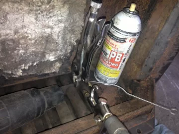

I got this old EF-3 and the rake is rusted solid!
Tried the PB blaster, wire brush, and wiggling with the vice grips and blasting out dirt with the compressor while vacuuming. I got the rake to move 1/8" and now 1/4" back and forth after 3 days of soaking and wiggling.

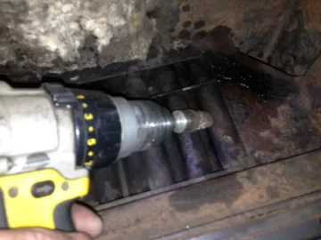

Now the problem seems to be all the corrosion on the heat tubes. I can easily get that rust and corrosion I can see on the bottom of the tubes with the wire wheel on the drill driver bit not the top of the tubes. The top row is especially difficult. Any ideas?
See pics below.

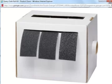

This emery cloth roll kit from from Grainger could do the trick. (broken link removed)
A length of app. 20 inch of the emery cloth is inserted between the tubes. To pull out the inserted end, you'll need a piece of steel wire, where you shape the end to form a hook. It may take several attemps to catch the far end. Hope this will work for you. Good luck.
[Hearth.com] Really stuck cleaning rake. Any suggestions?
