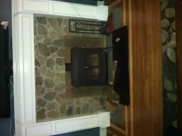

Not sure why that is turned. The mantel is 51 inches high. 66 1/2 wide. And the fireplace opening is 31 inches high and 43 wide
You have an iPhone. Turn it by 90 degrees before taking the picture.
Does the fireplace have a masonry flue? First, you will be better off with a frontloading stove. Second, a soapstone stove would be kind of a waste as the radiant heat will be blocked on most sides. Plus, the fireplace itself will act as a large thermal mass. Is it an interior fireplace?
The chimney is exterior. It is a masonry fireplace lined with a 6 inch flex liner not yet insulated

Since you need a rear-vented stove your options are limited and have been mentioned already:
Quadrafire Isle Royale
Hearthstone Manchester
Woodstock Progress Hybrid would not work well with the side-loading door and the Jotul F600 has essentially the same problem plus it needs a higher lintel.
Woodstock Ideal Steel would work but may not fit your taste.
Jotul F55 is a frontloader but also requires a higher lintel. You could inquire about a short leg option to make it fit.
I expect you need to extend the hearth for any of those.
If you will consider an insert you would have a bunch of different choices.
Can someone tell me what the clearence is from the top of the stove to the mantel on the IS. Also if I use my existing black hearth pad to get the 16 inch front clearence is that ok? Last the stone that is in front of the actual fire place is solid blue stone, I believe it was 2-2 1/2 inches think is that sufficient for the requirements

From page 5 in the Model 210 manual:
"An unprotected wood mantel needs to be a minimum of 30" from the top of the stove. If a mantel shield is installed that clearance can be reduced to 12 inches."
My solution (since I replaced an insert) is to sit the stove out far enough that it isn't under the mantel, then run double wall pipe under the mantel to the cleanout tee.
Second: Depends on the R value of your existing black hearth pad. You need R value of 0.41 for your entire hearth.
Last: What is beneath that stone? The big deal is if you have combustibles under it. If there are combustibles under that stone, then it depends on the R value of the stone (most are considered 0.080 per inch if unknown).
Let me know, I would be glad to help.
Just an add on......the black hearth pad in front would be helpful for embers, but the real issue is that A LOT of heat comes out of the front glass on this stove. I think looking at your picture again it would really cause problems if you got that stove up in the 650 degree range and didn't have proper protection/clearances in the front.
Here is the link to the manual currently posted on the Isle Royale website: (broken link removed to http://hearthnhome.com/downloads/installManuals/250_5763.pdf)
Mantel clearance is 36" or 14" with heat shield. The hearth requirement is steep: 0.45 k-value, I think that's about a r-value of 2 or 1" of Micore. See also here:

I doubt your current stoveboard has that.
If your house is as well insulated as you say, you can take a look at the Quadrafire Explorer 2.
(broken link removed to http://hearthnhome.com/downloads/installManuals/7061_197.pdf)
Its mantel and hearth requirements seem to be lower and with a 2.4 cu ft firebox you may be ok most of the time.
The stone sits on a poured concrete pad. Are there hearth pads available that I could buy to meet the requirements if I had to lay part of it on the hardwood. I was thinking I could leave it there for the burning season and remove it for the off season instead of extending the hearth. Thanks a lot guys for all of your input, a lot of this is new to me.

In that case the stone would be good.
Most likely you would be best to build your own.
http://store.woodstove.com/search.php?mode=search&page=1
Woodstock sells hearth pads pre-made, but they are high.
You really want a continuous protection layer with the correct R value.
Now there are some stoves that only require ember protection. You may want to do some searches on those. They tend to be built with lots of shielding in place. I think they don't generally heat well, but that is my opinion.
Some of the best heaters require ember protection only. Lopi stoves for example, a lot of Quads, PE stoves, etc..
A typical type 2 pad has a r-value of 1.5. You may need a custom one to get the required k-value of the Isle Royale. This place here should not be too far from you: http://ajhearthoriginals.com/about/ (FYI only; I have no experience with them.) If you look around there are probably more. Or you can try building your own: (broken link removed)
Make sure your building inspector is ok with a removable hearth pad. Some may require a fixed installation.

I started looking at the jotuls. Anyone have info on the 50TL that looks like a nice stove. Correct me if I'm wrong but my current hearth pad should work. I think I would have to install a mantel shield which isn't the end of the world. Any thoughts on this? Thanks again
From the F50/Rangeley's manual (page 9):
"The Jøtul F 50 TL may be installed into a masonry fireplace with a minimum opening height of 30 1/2” (77.5 c m). NOTE: There is no short leg option. DO NOT ALTER OR REMOVE THE LEGS."
Was your opening not lower than that?
With the bottom heat-shield only ember protection is required for a hearth. Thus, your stoveboard or any non-combustible material covering the floor will be sufficient.
