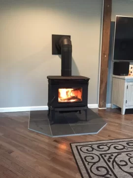

Second, as your father-in-law has noted, VC was once a great company with excellent product. Unfortunately, that time may have been three decades and four owners ago. Do a little reading on VC on this forum and elsewhere, and it will almost certainly be enough to sway your opinion against VC. Very pretty stoves, but a horrendous reliability record, backed up by an even worse customer service record.
If you like the VC look, but want a better quality product in a small package, there's always the Pacific Energy Alderlea T4, Jotul F100 (or F3 CB), or several other "pretty" stoves from which you can choose.
![[Hearth.com] Recommendations for a totally new hearth setup [Hearth.com] Recommendations for a totally new hearth setup](https://www.hearth.com/talk/data/attachments/230/230805-ffdb26317fcf5207454b3e024995777f.jpg?hash=59u7JMdfwy)
