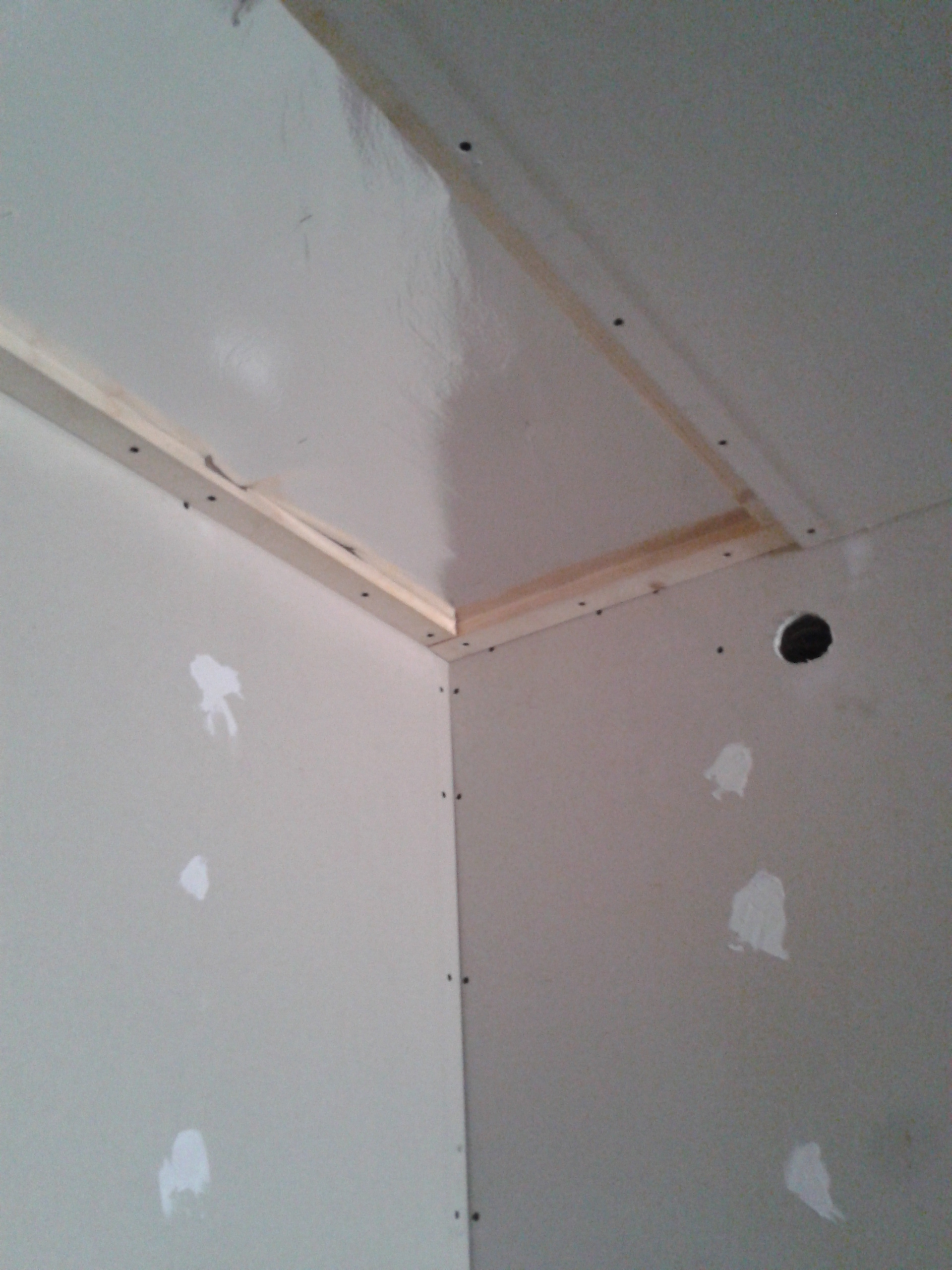

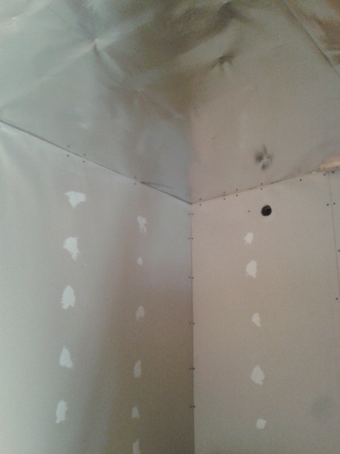

Then I put up reflective material across the entire ceiling.
[Hearth.com] Reflector... for ceiling?
And added a one inch air space, and put up dry wall ceiling.
