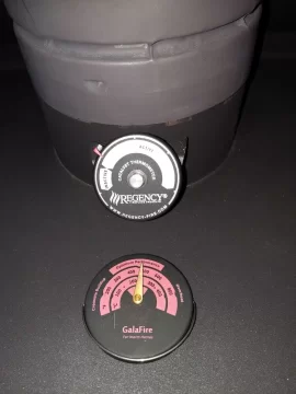

  2. The flue-collar thermometer provided has an 'active' and 'inactive' range - see pic, so I can't tell what the temperature is. Would anyone recommend switching this out for a thermometer (that provides the actual temp), or adding a second thermometer further up the flue?

I have a stovetop thermometer - see previous pic, which always heads to 800F ("overheat") when I get the firebox started. I then in turn adjust the air damper to bring the temperature down to 600F, which requires significant adjustment.

Pic: 20 mins after cat engaged (once it passed into 'active'), with air supply open
That looks better. Getting warm now? If the air is now reduced 50% does the cat temp drop a lot too?
Yep - so, after firing the stove with the air supply open for 30+ minutes after engaging the cat, I progressively adjusted the air damper to manage the burn. After 20 mins or so, both the stovetop thermometer and cat thermometer have dropped - see pic compared to previous.
For owners of a cat stove - would you expect the same behaviour, or would you expect the flue temperatures to remain at a higher temp vs. the stove top?
@begreen - yes the 2 temperatures seem to move commensurately
As long as the cat temp is in the active zone, then it's doing it's work. The wood gases in this stove are first being consumed by the secondary combustion, followed by the cat for cleanup of residuals. The catalyst in a pure cat stove has a lot more smoke to munch on. You need to ask these questions of cat-hybrid owners. That's why I added this to the title.
