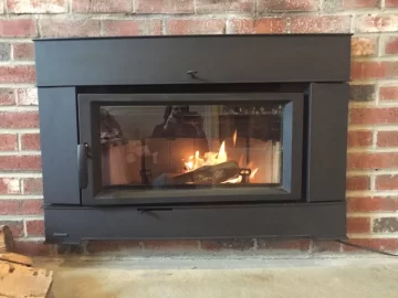

Thanks! I'll keep that in mind. I had planned to buy some biobricks as a backup, but the manufacturer said it'd void my warranty. We don't have a lot of wood split. About 1 cord is dry and split. But we've had a lot of warm wet weather. The more recently split pile (which is also less than a cord) is fluctuating between 16-24% moisture.
It's was 50 here yesterday, so we'll have to see how it performs when it's colder. It was 40 last night and it heated my whole house! We only put one log in every few hours and it reached 72 in an adjacent room and didn't go below 60 even at the opposite end of the house, upstairs. Our house is a 2800sf volume with a couple of cathedral spaces too.
I didn't draft it down last night or really load it up and we were down to coals by 6am. Tonight I'll see if I can get 8 hrs of a healthy fire.
The glass on the door is dirty though. And I cleaned it yesterday. :( I've read threads on that- once it's cold it should go away. Should I clean it again? It was a lot of work.
I'm so happy with this unit (thus far)! I've wanted one for many years! I love being warm!

My experience with this insert is it becomes more difficult to clean if you let it build up over several burns. I haven't had luck with hot fires cleaning the glass, but I haven't had the insert that long.
You should join the CI2600 operation thread now that you are up and running.
Will the glass not clean up with a damp paper towel? Get a little ash on the paper towel if the glass is really bad.
My experience is you get a really difficult to remove black creosote coating. There is some of the easier brown stuff that just wipes off but the black coating takes a lot of time and effort even with chemicals.
I'm getting a thick coating on the glass now, part of it is iridescent too. I cleaned it on Sat, but not since because the stove has to be cold to do it.
Now i cannot get the downstairs temp to go above 67::F. It appears that the fire lasted all night though. I loaded it with 4 splits. Our splits are really small, in my opinion. 3" thick and 16" long. Looks like each log was cut into 4 splits. When it was warm out (50::Fs during day/40::F at night) on the weekend we were able to heat the whole house loading 1 split at a time. Now I'm putting it 2 at a time and cannot get it above 67::F. It is windy though. But it's not that cold outside (35::F) now either.
I had to open the air control 100% - the house didn't heat up at all with it 1/2 open. Maybe I need to really load it up with a full box? Can I load it all the way to the top or does it need air space?
Maybe I should mention my each floor in our house is 1,350sf, and the first floor has 2 cathedral areas, including the room the stove is in. :confused:
Any input would be appreciated.
TIA
Yes, the glass is really bad... Black. It's very difficult to clean off. I have noticed that once I started bigger fires yesterday, part of it seems to be burning off in the corners.
