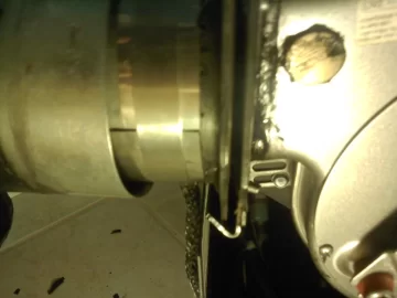

    Okay here is what I found. I called the dealer and lit a fire unders there arss. I always have complained about smoke smell from the flange gasket even though it is tight. Here is a picture and you can see, where th bottom of the gasket is dirty from a leak.

    One other thing. Is the pipe sealed on the outside where it goes through the wall thimble and do you have an outside air kit?

    was the bolt on the flange tight? Glad you found that and hope thats the problem.

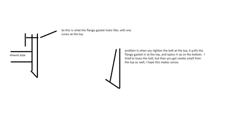

    Here is a drawing I hope this makes sense.

    I did tighten the bolt some, but It was in there pretty good. Im wondering if I could take a new gaket, put some silicone sealent on each side of the gasket, and sandwhich it in there, and tighten it down. That being said when it needs to be cleaned, I would have to scrape it all off to get it apart. Im going to try and fill in that stove adapeter as well. The dealer is suppose to call me this afternoon but we will see if that happens.

    The only thing holding the bottom in is the angled piece of steel and then the top bolt pulls it together. I was able to tighten mine more than the way it came from the factory. The gasket looks good, I would flip it over (top on bottom, bottom on top) put back together and tighten that bolt up really good before you go silicone crazy.If it still leaks from bottom that angle piece might need to be bent up a little more to hold the bottom tighter.Good luck. Your getting close to fixing this problem.

    If that picture is your stove It looks to me that the top isn't pulled in as much as the bottom.

    I like the stove, but I have to tell you sherwood dropped the ball on this design. If they would of made a flat flange gast, with bolts on top and bottom it would be so much easier, and a tighter gasket this design is lacking!

    that is mystove, but no bolt there, thats why it looks like that. I just wanted a refrence picture so the folks could understand here how this flange goes together.

    What im saying is that the space on top is grater than the space on bottom witch would mean the bolt on top needs to be tightened more. My stove is the same set up and I had the same problem. I tightened bolt and siliconed between the inner and outer pipes and no more smoke smell. I did both at the same time so I dont know witch one was the problem but No more smell. Im on my second year.

    I appreciate all your help and suggestions, and were on the same page. I just do not like the design cause the way it is set up, when that bolt is tightened all the way down, the only thing holding the bottomis that bent lip on the steel. So you are always going to have a tighter fit at the top then the bottom. Kykel I will take all your suggestions and implement them and fire her off. I still feel this should work. My family member has chronic bronchitis, she never smoke a cig a day in her life, but things affect her and thats why I went with a pellet stove vs a wood stove. My theory or thinking thou it may be wrong but with a pellet stove you have sealed combustion, and your not opening the door to add wood so I thought this would be a safe bet for her, but her health comes first so I will do what needs to be done.

    I just spoke to the dealer. He told me there are thousands of these stoves out there and he has never heard of a smoke smell complaint other then me. I explained to him about the obvious signs of a leak on the gasket, and he said I do not believe you. He said it has to be your pipe. He then said he would have sherwood call me, so that is where we stand at this point in time. Oh and he did offer to send me a new gaket. Thanks everyone for letting me vent, Im beyond frusturated as you can imagine.

    99.9 % of the time its exhaust related, But for the dealer to say he doesn't believe you is a joke. He should come and replace the gasket himself.
