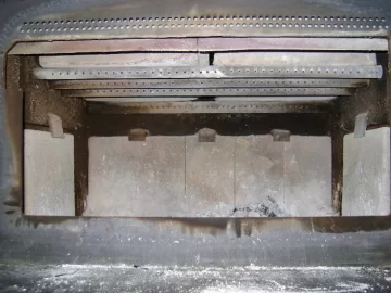

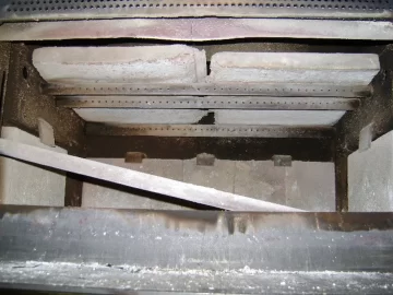

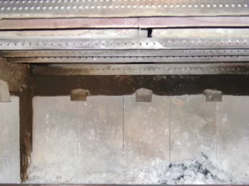

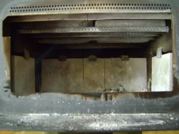

Reading all posts here I guess I must be a lucky guy because I bought my Regency I3100 S/N: 38953 back in Nov-2000 and have been using it every season burning about 6 face cords of hardwood with no problems at all. I keep the damper always to about the midpoint and very seldom I use it to the fully extended position perhaps for 10-20 minutes (to get new logs get going).
My small problem (and that’s why I’m here) started last month when the chimney guys came for the annual cleaning which I do every 2-3 years. I must confess that although I’m a man who fixes everything in my house I never bothered to learn anything in my fireplace, somehow I felt it was a simple firebox and no need to spend the time to do anything except to remove the ashes as needed. In addition since my house is a 2 story house with a high pitched roof which I’m afraid to climb I decided to let someone else to do this job.
About 2 weeks after the chimney cleaning and while the fireplace was going for about 4 hours I hear a metallic noise inside the firebox. When I opened the door I saw a pipe had fallen down right behind the door but it was hanging from the left side wall. I felt something was wrong and decided to stop the fire and using a shovel emptied the burning firewood to my concrete patio which is right next to the fireplace.
Next day and after searching some YouTube videos I grabbed the pipe with my vice-grip and hammered in to the right wall notch. At the same time I noticed the 2 firebrick above these pipes were kind of burned on the ends and I was upset that the chimney cleaning guys never said anything about it. The fallen pipe looks solid (not burned) and the ends are not burned either but I wonder why it fell down again,
So now since I don’t trust the chimney cleaning guys anymore I must educate myself on how the fireplace works and here are my questions.
1. There are 4 similar tubes at the top of my firebox and all have similar small holes on them. What is the purpose of these holes?
2. Why this pipe fell again after I hammer it? I know there is a notch on the pipes end and a prong in the firebox wall and I hammer it well but perhaps I didn’t hammered enough?
3. What is the purpose of the 2 firebrick above these pipes? To prevent the flames touching the metal box or they serve some other reason?
4. The dealer told me that the new part (063-955) is not firebricks but some kind of a baffle. Would the new part fit my 18 years old firebox? The dealer has no idea.
5. Some members on this thread have mentioned about cracks in the firebox. How can I inspect my firebox about cracks? Kind of difficult to find cracks in the firebox if you don’t know how/where to look for.

I would try to get the manual, maybe off the Regency website. It'll have a lot of good info in it.
Those baffles do look beat to me, so I think replacing would be good.
I believe removal of a tube is not necessary to remove the baffles (see manual). It takes a little 'finagling' on my Hampton HI300, but doable. Perhaps a sweep removed a tube in the past and that is why it was loose.
The baffle slows the flames down and redirects them so less heat goes up the chimney. It is necessary.
I clean my chimney myself but I do it from the bottom, so that's a possibility. I can see not getting involved in certain things while doing a bunch of other stuff. That's getting less as time goes on, lol.

The baffle keeps the temperatures up in the firebox to allow for secondary combustion and extends the smoke path so more heat can be extracted. The tubes introduce fresh preheated air under that baffle which burns off combustible material left in the smoke. This gives you more heat and a cleaner burn.
The tube fell out because over time that notch spreads open a bit. When the sweep removed it it spread it a tiny bit more so it no longer holds the tube in place. Take a pair of plyers and squeeze it closed slightly and it will stay in place.
And yes you need new baffles.
