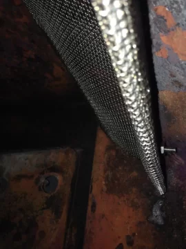

The Regency manual recommends that the baffles be fully pushed back and totally tight to the sides...if all is well you should be left with a 1/8-1/4" inch gap in the center baffle overlap...below is a picture of how it should look....
  • [Hearth.com] Regency i3100 Insert Baffle
Thank you....this is how the unit is setup. It runs great.....well insulated flue and the like.....first impression: love it!

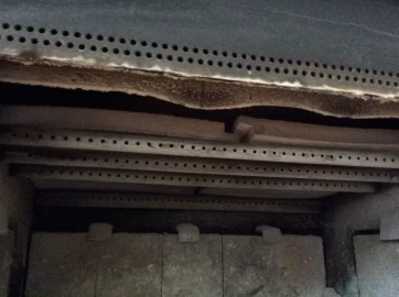

Have attached a Picture below of the now very visible issues, regarding baffles and deflector deterioration, been burning small fires and limping in the last few days, while working out a plan. Currently living an unacceptable status with cold coming and a high dependancy of the 3100 as our primary heat source.
To address my concerns, will be performing the following steps to restore the 3100 to a deemed "healthy" status:
1)Replace the ceramic baffles (063-955) and will perform an indepth comparison of the new baffles to the 2 month old baffles installed in the 3100 that are distorting badly and very rapidly.
2) Dissasembly and Close Inspection of the 3/4" air tubes, tubes 1-3 from front....will be compared to new, in looking for any possible changes in the existing air tubes.
3) Investigating the retrofit to my older 3100 (same for I3100 or F3100) of a new replaceable deflector, Regency part # 820-484C, a stainless deflector (a 2014 Regency redesign?), that clips onto bolts attached to the upper front face of the 3100 series stove. Am also hoping that Regency might have a retrofit kit (and provide some guidance) for retrofitting this part onto my 2011, I3100 unit, which currently has a spot welded steel deflector, in pretty bad shape. Seems to me that bold placement will have little tolerance for assembly/dissassembly.
4) May perform a change of the door gaskets, although they seem do seem to be very airtight.
Am currently thinking that an intact deflector may be a very important component of the Regency stove, in ensuring a healthy longevity.

So after total dissasembly and full inspection of the unit, reassembled my 3100 and it is back up to operation on new baffles .. also flipped in a a couple of different spare air tubes to be sure.....and was surprised to find that one of the air tubes in the unit, was actally a 1/4" shorter than the others? might have been the one popping out on occasion from expansion and vibration....probably and am crossing my fingers
Observed that new baffles are now naturally drying with a curve (invard concave on the rough side), a recent issue since 2013 methinks. The new ones (just acquired) have a beginning of a curve already (from sitting in a demo unit and before the very 1st fire). I can just imagine their status and condition after 5-6 cords of heat and by February....we'll see then.
What is nice is that the new baffles are 28.5 centimetres in width on the rough side x2, vs the previous set at 28 centimetres. New baffles are therefore providing 1 centimeter more coverage overall and when assembled, the unit is now back to a 1/4" gap...picture below. Begs the question: Are there 2 different moulds being used in ceramic baffle manufacturing, 2 different sub-manufacturers, quite a mystery to me. If replacing baffles and if you have a choice, suggest that the 285 mm baffle is a better fit, both seem to have the (063-955) code.
To note that Ceramic baffles are delicate, especially once they have been used and heat dried. Be very careful on removal for chimney sweep as that handling alone can easily chip and crack. As an example, brought my 2 month old baffles to dealer for comparison, they were in a box and cracked/chipped just from vehicle transport.
Suggest from my experience that for the folks often using older 3100 units, (2002-2013), that are ignoring a deteriorating 3100 deflector condition and/or poor baffle condition may cause much more and larger issues. My original I3100 was in the 1st thousand produced and there are likely more than 20,000 3100's series units out there now, assuming that 20-30% are likely getting frequent use, a greater number of people will be encountering issues, jeoparding longevity.

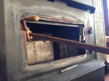

I've had a freestanding 3100 since 2005. Tried to replace baffles this year and had a heck of a time locating a set. Waited for weeks to hear back from my dealer and finally gave up and replaced baffles with a 3/8 steel plate that is approximately 1" short of stove width, so there's a 1/2" gap on each side of the baffle. I think this is causing my stove to consume more wood and burn less efficiently. It seems these baffles are hard to get, which is my one complaint with this stove. I've heated a 3200 sq. ft. story and a half house almost exclusively with this stove for 10 years. I keep a thermometer on the chimney 18" up form the stove top and keep the chimney temp at 200 degrees F minimum. I sweep once a year at the end of the season and get about a large coffee can of creosote on average.
The past couple years, even before replacing the baffles, I've noticed that to keep flue temp up, I often have to burn with door cracked open. Any input as to why? Is it just the fact that baffles were worn out? Seems like I'd have higher flue temps if that's the case, not lower. Love this thread. It's been very informative. Even though I've burned for a long time and been through at least 55 full cords of wood, I still feel like I don't know what I'm doing. I'm open to any input you can give. Even tell me how stupid I am if you want. I'm thick skinned, willing to listen, and want to learn.
On a side note, I'm thinking of starting a company to make these darn baffles cause there seems to be a pretty high demand for them and not a lot of supply!!

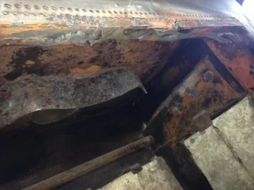

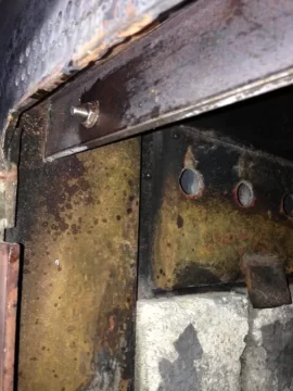

We have a Regency I3100 that we've had for about 11/12 years and use continuously during the roughly 5-6 month heating season in New England.
My experience is that the stove is pretty cheaply made in some key areas, most notably the front deflector, which I've replaced about four times by bolting new 1/4" x 1-1/2" steel bars into the remaining remnants of the original deflector, at the ends.
Regency talks about "overfiring" as a way of sidestepping the issue that, in my opinion, the stove is not a great piece of manufacturing/engineering; there are more ways to overfire than I can list here.
I've found that regular use, with dry cordwood, with the intake shut down, with optimal practices per the instructions, still produces burned through metal at the top front of the stove, period.
I think that the design flaw lies in having the hottest, most concentrated flame directed at what is essentially unprotected plain steel. If it were all stainless steel, it might fare better, but it isn't.
One can't really be aware of the issue until you've owned the stove and used it continuously for awhile.

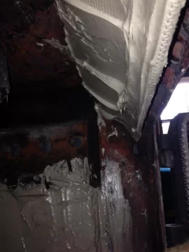

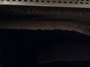

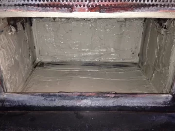

So, this year, when I replaced my deflector and patched up the baffles/firebricks, I also formed an armature of stainless steel mesh, https://www.amazon.com/gp/product/B01N4RCHFU/?tag=hearthamazon-20
covered the damaged top/front area, then plastered this with fire cement, thus covering the steel elements that had begun to burn through (even when used according to Regency's directions).
Voila! the area is now protected with a layer of cement, working like a custom-formed firebrick, which is keeping the steel protected. When I installed and "plastered" the stainless steel mesh, I ensured that the top passage remained open, so that the air-wash feature would continue to work.

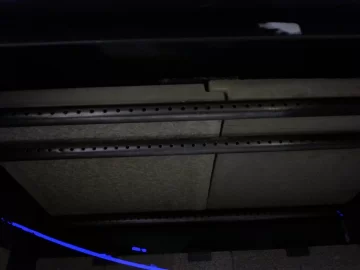

I've attached photos of "before," the process, "during," and "after," before curing the fire cement. We've been using it for a month, since; it is working better than ever.

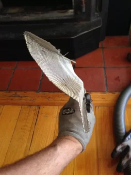

Also, my top baffles wore out over the years, were cracked and in pieces, etc. I laid them out on waxed paper on a flat sheet, fire cemented them together, using stainless steel mesh as "re-bar" across the joints, and took pains to reform the mating half-lap joint (again, with wax paper between the drying slabs, so that they didn't get stuck together).
They are better than ever. This approach has worked well, saved me money replacing firebricks/baffles, and is easily done by anyone who is a bit handy.
So, in summary, one can mend firebricks or baffles with stove cement, and improve the stove's design by covering the top front area with fire cement plastered onto a stainless steel armature. I hope that this helps another Regency owner...
With a little stove polish, the unit looks good as new and is actually better than new, with the new/improved protection of the vulnerable top/front area.

We have a Regency I3100 that we've had for about 11 years and use continuously during the roughly 5-6 month heating season in New England.
covered the damaged top/front area, then plastered this with fire cement, thus covering the steel elements that burn through, even when used perfectly.

With my new, improved, fire-cemented-over-stainless-mesh-deflector area, I expect this unit to last for several more years of daily use. My only hope is to help another Regency owner improve their unit, should they experience the kind of burn through, in that area, that we've seen.
The photos and comments from other Regency owners, earlier in this thread, led me to think that photos of my fix might be helpful. I hope that they are.
I hope that my photos outline the process I followed. I'd be happy to answer any questions from those who care to replicate this improvement.
Reactions: joneo

Hey, the same thing happened to the my Hampton and the same reaction from the dealer (there was another thread on this). It burned right through. I had heard they replaced them with stainless, but this fix was not available to Americans. I want to thank you Erik for the great info.
Yes all new ones have stainless deflector. They have for a couple years now. We retro fit any that we sold that get damaged. Is the face of your stove distorted and cracked as well?
