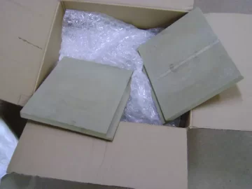

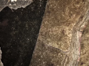

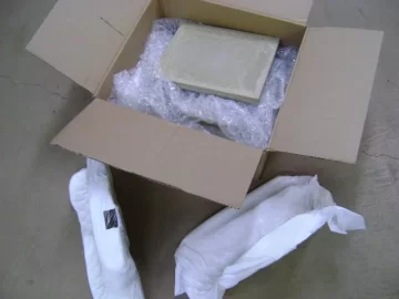

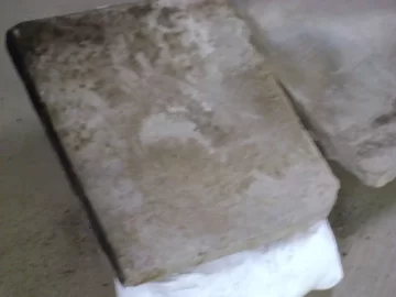

Hello bholler, got a surprise today because the guy told me that my baffles arrived.
I picked them up and started the installation. I had to remove 2 pipes to install them because in front of the chimney opening there is a metal baffle about 3”-4” high which prevents me to lift / tilt the second baffle.
The new baffles have one surface smooth like glass and the other face is kind of unfinished rough. I don’t know which side is facing the flames and I decided to have the smooth side to face the flames. The old ones one had the smooth side facing up and the other I can’t say because is heavily pitted on both sides.
Does it matter which side faces the flames?
On one smooth side will be down on the other smooth side up
Reactions: oskar470
I guess you know everything bholler, good show
I realized afterwards there is no way to have both baffles with the smooth sides down. It’s done and fireplace is ON now.

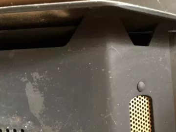

Now that I had to remove the old baffles I noticed the chimney opening at the back of the firebox. Another member here had mentioned that he cleans his chimney from inside the firebox going up. I think it will be very difficult to do so because I believe there must be an elbow somewhere just above the firebox and this elbow may prevent pushing the brush up.
Next spring I will see what I will do. I don’t trust the guys used to come but I may search to see if there are individuals who do this job and perhaps there are much better than the ones I used to get.

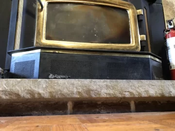

If the hearth is raised several inches then a simple hearth extension at floor level might be ok with just ember protection. The stove sounds like it has been run yearly inspite of increasing defects. This can lead to cascading failures, especially if air is leaking in and the baffle is shot. We can't judge much without seeing what you are seeing, but the likelihood of this being covered under warranty is slim.

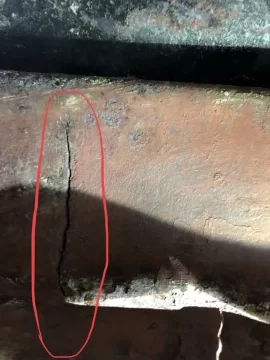

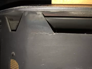

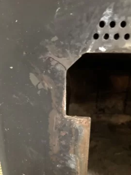

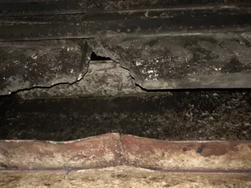

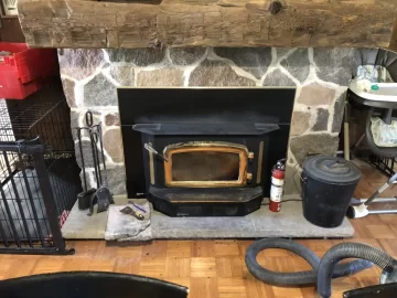

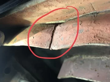

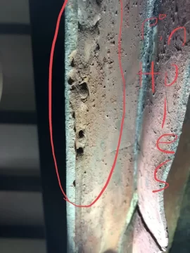

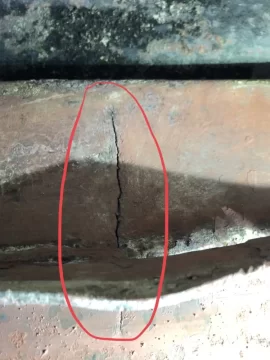

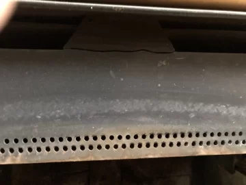

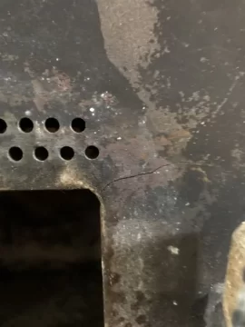

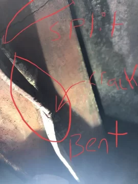

Found several problems inside the stove that need to be repaired. See pictures.
-Noticed inside corners on left n right cracked.
-Noticed inside metal deflector bent n cracked with a good gap where it cracked.
-Noticed 3 to 4” crack in the box by the deflector under the top.
-Noticed some rusted pinholes near the inner lip
-Cracks along the top where the blower comes across to the metal supports.
Seeing how the warranty wouldn’t cover this I’d imagine we are going to re weld this puppy up.
We are going to have to cut a section of the metal deflector off to fix that one crack. Should we just weld a new deflector to the old one? My dad has some steel to make one. Or is it worth while doing a bolt on instead? Ether way I don’t think the deflector having a crack n gap like it does would be nice to just bolt a new one up-to as there would then be a gap still.
Need to find replacement baffles and some new fire block bricks too. Any recommendations for the Durham area? Looks like I might need to install some tile or hearth extension in front of the stove as you can see the ember marks on the parquet flooring in the last picture. Sorry for the mess here, just finished cleaning the stove out and wire brushing it, now everything else to be cleaned haha.

You are right, they will not transfer the warranty over to me even if I have all of the original receipts etc. Sad.
That stove is too far gone. It's scrap
You don’t think if we fix it with welds and maybe some plating that it’s worth while? I think it’s the cost of a new stove that’s scary. Is this same model still available but in a newer style? Or is there a different style equivalent? We planned on using it to heat our home for s few winters to build up money for a propane system eventually.
That's worse than I had visualized. The stove is in bad shape.
The i3000 has been replaced by the i3100 which has a good long track record. While looking, compare this to the Osburn 2400 insert and the Pacific Energy Summit.
Not with as much cracking in as many different areas as that. And yes you can still buy a i3100 until the new set of regulations go into effect at the end of the year.
Well I think we’re going to give it a go with some welding n hope to get this winter out of it for now. I think it’s pretty obvious that some of these cracks formed n got worse from the neglect of not being fixed in the first place so hopefully by undoing the damage and reinforcing what we can, it’ll work a little while longer. So many expenses coming at once. It wasn’t intended to be the primary heat source for the home but we found electric baseboard heating to be ridiculously expensive last year (600-800$/mo). Crazy when we have acres of wood available. I get this feeling no one wants to save a dollar anymore, but how do you get ahead if you don’t?
Any solid recommendations on a new stove with the same or very similar dimensions as this one? Any expected price idea in CAD?
If it wasn't for the multiple cracks in the face I would go for it. But that looks bad. Have you checked the face and the door with a straight edge?
