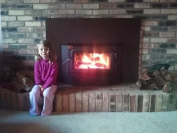

Hey hummer..i have been running a R14 for about 2 yrs now. You should be pretty pleased with how it performs. I have a 2400 sq ft house that is not open at all...its all chopped up...i can usually get the fam room insert is in up to 80-82...rest of first floor up to 72-74...upstairs bedrooms prob 68. Your house is set up perfectly for heating. Try putting a fan in hallway of uppermost floor blowing down the stairs...this wii create a convection loop where the cooler air coming down the steps will displace the hotter air and push it upstairs. my operating temps...can usually get her up to 500-550...get a nice secondary burn. I put my thermometer left hand upper face just off the door...i'll try to post a pic....any ?'s let me know
Hey hummer here is a pic...i painted mine dark brown

Wow very nice insert, cute little girl you have there, I have a little baby on the way but my wife and I can't find out till October and its driving us nuts to see if its a boy or a girl but anyway, thank you for the response, I really appreciate it. Its funny because my insert is like brand new (manuf. in 1991)and bought it off a lady who never really used it and just wanted to get rid of it for 450 bucks so I said sold. I put a 6 inch full liner in and I have big expectations for this insert. I have the gold door and trim which I am not too crazy about, I wish it was all black like yours, I will get a pic soon. I bought a thermostat for it as well and put it on the same place you did so we will see. Do you burn 24/7 and also how long are your burn times with the R14........any luck with overnight burns?
over night burns....there are some hot coals by am to restart, but I cant get good heat in the early am hours..so my furnace kicks in a bit in early am. You may have better luck since your house is way better for heating...not so cut up. Get a hand sander with super fine grit...sand off all the brass color..then steel wool...paint with stove paint....it was pretty easy.

Yeah hummer, my wife was a little unsure about it too..until our first ripping fire and she is watching tv sitting in front of the hearth. She loves it now. She loves being warm now. We both love the huge glass for viewing the fire. On the sanding of the brass....i used a hand electric sander..worked great. I got my insert for about 550...same thing some older lady didnt use it much and some guy bought it but it didnt fir in his fireplace.
