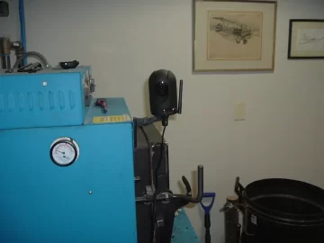

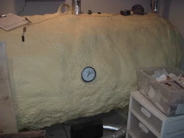

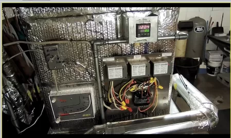

some pictures of my boilercam, allows seeing boiler temps and storage temps with the preset function which allows automatic zoom to the desired views (hence the big gauge on the storage tank) works great.The camera is a 60$ Foscam from ebay Bruce
wow you have yours in a fished basement? looks very nice

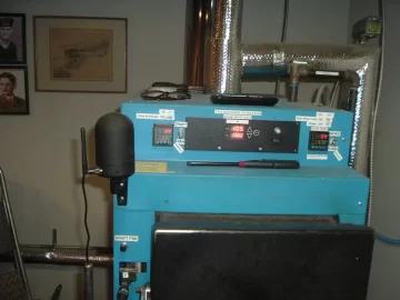

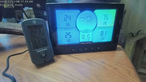

I'm also using two of those Foscam IP cameras to remotely monitor various indoor/outdoor/furnace temps and draft throughout the day while I'm at work.
