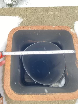

I feel this is dumb question that I know the answer to but I figured I’d ask before I tear anything out just in case.
I have an existing metal liner in my clay flue that my old, traditional-style fireplace used. The liner is big enough to fit my new liner within it (insulation and all) but the old liner has screws protruding about a 3/4 of an inch into the center of it.
I’m afraid if I remove the old liner, there will be too much space between the walls of the clay flue and my new liner’s insulation. I haven’t assembled my new one yet but I’m going to estimate and say there will be about 1.5” of space around on all sides of my new liner once installed. ’m also afraid that if I don’t remove the liner that I’ll have to figure out how to grind down those screws so it doesn’t destroy my insulation.
Would it be best to just remove the old liner before installing the new one? If so, do I need to do anything else to ensure I get a good draft? My chimney is about 30’ tall, is on an exterior wall but the chimney itself is within the wall (can’t be seen running up the side of my house) and the only piece you can see outside is about 4’ of it sticking out above my roof.
Of course I have a 14”x14” piece/plate that will cover the top of my chimney but wasn’t sure if I’ll still need to acquire more/special insulation to plug any holes.
Thank you!

I would pull it

Me too. I don’t see how the screws wouldn’t tear up the insulation on the new liner

Thank you! I agree that I don’t see how it wouldn’t tear it up. I was wondering though if someone was going to suggest I get a different liner with a larger diameter or something.
Do you think it would cause issues if I doubled-up the insulation wrap on the bottom few feet of the liner just to ensure it’s more sealed?

I would put extra insulation above the block off plate, and also at the top 4 feet of the chimney, the part that sticks out above the roof.

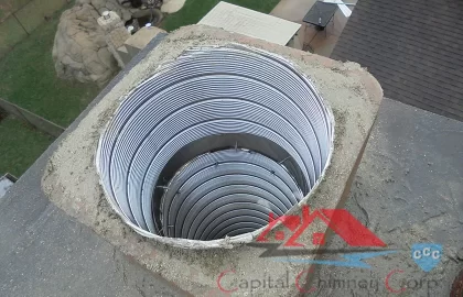

On a similar topic. I just removed a wood insert from my chimney as I was unable to have it swept due to a welded baffle so converting back to a wood burning fireplace. The guy removing it said the liner has to be removed to burn. He is sketchy as I have been waiting for 3 weeks for him to pull the liner although he took the stove away and installed the new glass doors. To remove the cemented-in liner, what do you recommend to do? Drill holes and chisel? I was looking to find options to retain the liner but can't find any pans for the base of the liner to block the chimney except for the liner hole. Thanks!
The liner most likely isn't big enough anyway it will need to come out then the old one inspected

You may be able to cut some of it with an angle grinder, but I think a chisel will be your best bet.

Any recommendations as to how to remove the cemented in liner without damaging the clay pipe? I think this guy stiffed me so will need to do it myself. Thanks.
Cemented just at the top? Or the bottom? Or the whole thing?

I looked back at the liner pic at the beginning and it doesn’t look like pour in. I’m hoping the installer just cemented in the bottom.
