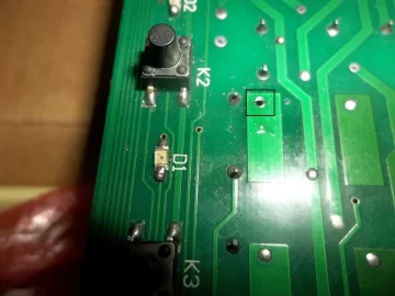

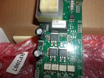

Hi I got the Triac off.
It was like glued and looked like soldered from back of board to front corner of the Triac heatsink?
See pics.
Now waiting for new Triacs from mouser.
Thanks for help.
Will post if fixed the problem or not once I replace the Triac.
