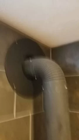

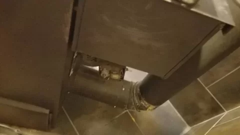

We bought a house with a coal stove in the basement. It does not have a permit, and needs some changes (namely hearth extensions) to be able to get one. Since we don't really need it in that room for now and honestly can't afford the expense, we'd like to remove it and store it and revisit it down the road.
I'll attach some photos of what it looks like. What do we need to do to remove it and cap it off on the inside? Any help greatly appreciated. We've tried finding someone local to help out but everyone seems to be booked for weeks or didn't get back to us at all.
Photos, I can take more if needed
[Hearth.com] Removing a coal stove[Hearth.com] Removing a coal stove[Hearth.com] Removing a coal stove

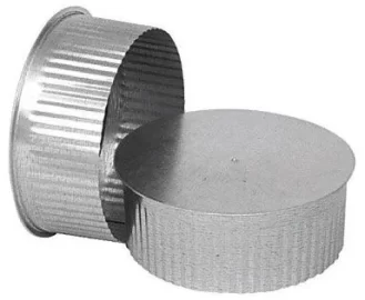

where are you planing to store it? most box stores have stove pipe plugs/caps/covers measure your pipe and get corresponding cover

That looks like an old Channing 2 stoker from Alaskan. And a filthy one at that. You need to vacuum it out well including the hopper. Also clean the burn tray well. Coat it with oil or penetrating oil as was suggested. Be sure to oil the burn tray and the feeder we'll. I'd also pull the fans and combustion blower off, lube them and keep them inside. Do you know if it still works?
