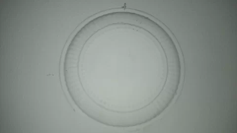

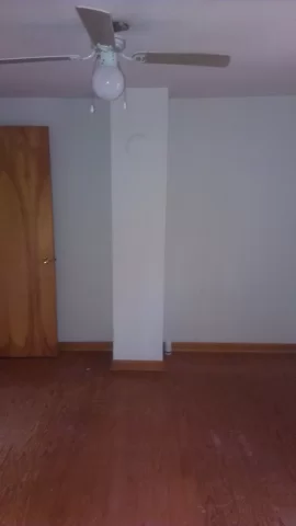

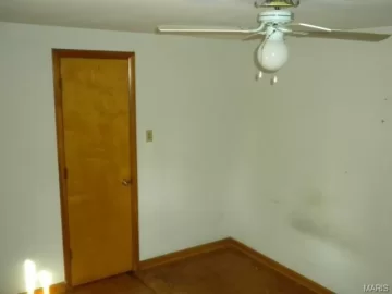

Was finally able to get pics today. Let me start with the inside pics. House is 862 sq. ft. in mid Missouri heated only by a Quadrafire 3100 wood stove in the living/room kitchen. That stove has enough to heat a house of that size but since I have this unused chimney in the 12x10 master bedroom it sure would be nice to have something in there...

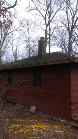

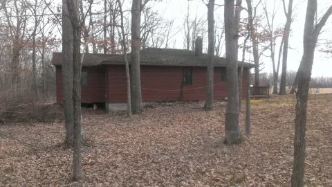

Exterior chimney pics -

Wood stoves in bedrooms are generally not such a good idea. To boot, many code agencies (if you have them in your area to worry about) don't allow it, same goes for insurance companies.
pen
Completely understand Pen. I'm just looking for options since the unused chimney is there. Doesn't have to be a wood stove. Insert? Something else cool?
If it's in a bedroom, then you are pretty much limited to a Direct-Vent Gas stove. They will heat the space nicely and most would be approved by code and by the insurance company.
